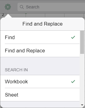

- if necessary, you can specify search parameters by tapping the
Search Options icon on the left.
The Find and Replace settings panel opens. You can adjust the following options:
- SEARCH IN - is used to search within the active Sheet only or the whole Workbook.
- SEARCH - is used to specify the direction that you want to search: to the right by rows or down by columns.
- LOOK IN - is used to specify whether you want to search the Value of the cells or their underlying Formulas.
- Match Case - turn on this switcher to find only the occurrences typed in the same case as your inquiry (e.g., if your inquiry is 'Editor' and this option is enabled, such words as 'editor' or 'EDITOR', etc., will not be found).
- Match Cell - turn on this switcher to find only the cells that do not contain any other characters besides the ones specified in your inquiry (e.g., if your inquiry is '56' and this option is enabled, the cells containing such data as '0.56' or '156', etc., will not be found).
- Highlight results - turn on this switcher to highlight all found occurrences at once. To disable this option and remove the highlight turn off this switcher.
To close the Find and Replace settings panel, tap outside of it.

Replace the found matches
- tap the
Search Options icon on the left to open the Find and Replace settings panel, - tap the Find and Replace menu item, change the search parameters, if necessary, and tap Done. The Find panel will change:
