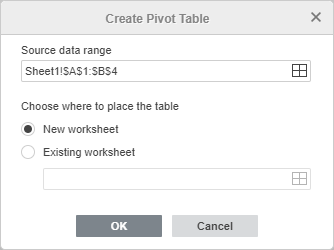

  4. The Create Pivot Table window will appear.
    • The Source data range is already specified. In this case, all data from the source data range will be used. If you want to change the data range (e.g., to include only a part of source data), click the change range icon icon. In the Select Data Range window, enter the necessary data range in the following format: Sheet1!$A$1:$E$10. You can also select the necessary cell range on the sheet using the mouse. When ready, click OK.
    • Specify where you want to place the pivot table.
      • The New worksheet option is selected by default. It allows you to place the pivot table in a new worksheet.
      • You can also select the Existing worksheet option and choose a certain cell. In this case, the selected cell will be the upper right cell of the created pivot table. To select a cell, click the change range icon icon.

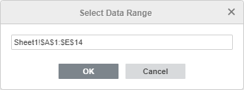

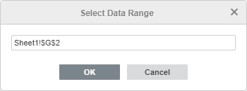

        In the Select Data Range window, enter the cell address in the following format: Sheet1!$G$2. You can also click the necessary cell in the sheet. When ready, click OK.
    • When you select the pivot table location, click OK in the Create Table window.

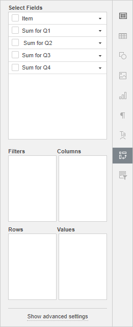

Select fields to display
The Select Fields section contains the fields named according to the column headers in your source data set. Each field contains values from the corresponding column of the source table. The following four sections are available below: Filters, Columns, Rows, and Values.
Check the fields you want to display in the pivot table. When you check a field, it will be added to one of the available sections on the right sidebar depending on the data type and will be displayed in the pivot table. Fields containing text values will be added to the Rows section; fields containing numeric values will be added to the Values section.
You can simply drag fields to the necessary section, as well as drag the fields between sections to quickly reorganize your pivot table. To remove a field from the current section, drag it out of this section.
In order to add a field to the necessary section, it's also possible to click the black arrow to the right of a field in the Select Fields section and choose the necessary option from the menu: Add to Filters, Add to Rows, Add to Columns, Add to Values.

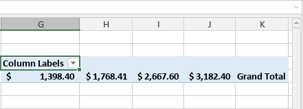

  • If you add a field to the Columns section, the pivot table will contain a number of columns equal to the number of values from the selected field. The Grand Total column will also be added.
    Pivot Columns

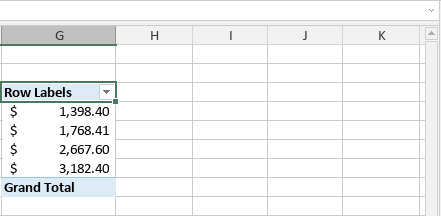

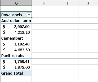

  • If you add a field to the Rows section, the pivot table will contain a number of rows equal to the number of values from the selected field. The Grand Total row will also be added.
    Pivot Rows

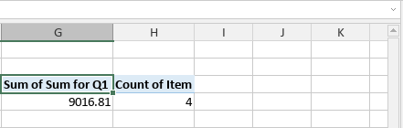

  • If you add a field to the Values section, the pivot table will display the summation value for all numeric values from the selected field. If the field contains text values, the count of values will be displayed. The function used to calculate the summation value can be changed in the field settings.
    Pivot Values

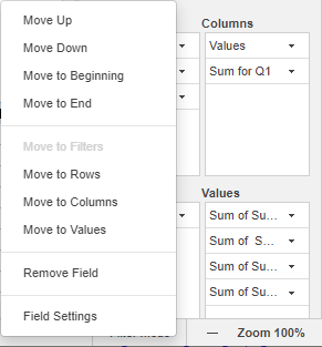

Rearrange fields and adjust their properties
Once the fields are added to the necessary sections, you can manage them to change the layout and format of the pivot table. Click the black arrow to the right of a field within the Filters, Columns, Rows, or Values sections to access the field context menu.
Pivot table menu
It allows you to:
  • Move the selected field Up, Down, to the Beginning, or to the End of the current section if you have added more than one field to the current section.
  • Move the selected field to a different section - to Filters, Columns, Rows, or Values. The option that corresponds to the current section will be disabled.
  • Remove the selected field from the current section.

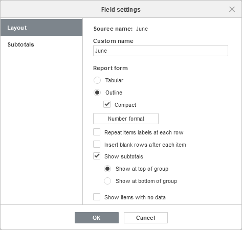

  • Adjust the selected field settings.
The Filters, Columns, and Rows field settings look similarly:
Pivot table Filters field settings
The Layout tab contains the following options:
  • The Source name option allows you to view the field name corresponding to the column header from the source data set.
  • The Custom name option allows you to change the name of the selected field displayed in the pivot table.
  • The Report Form section allows you to change the way the selected field is displayed in the pivot table:
    • Choose the necessary layout for the selected field in the pivot table:

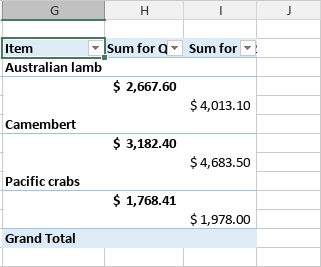

      • The Tabular form displays one column for each field and provides space for field headers.
      • The Outline form displays one column for each field and provides space for field headers. It also allows you to display subtotals at the top of groups.
      • The Compact form displays items from different row section fields in a single column.
    • The Number format option allows you to choose the required number format for the value field. Click this button, choose the required format from the Category list, then click OK when ready. To learn more about number formats, please refer to the following article.
    • The Repeat items labels at each row option allows you to visually group rows or columns together if you have multiple fields in the tabular form.
    • The Insert blank rows after each item option allows you to add blank lines after items of the selected field.

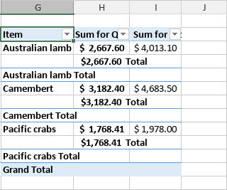

    • The Show subtotals option allows you to choose if you want to display subtotals for the selected field. You can select one of the options: Show at top of group or Show at bottom of group.
    • The Show items with no data option allows you to show or hide blank items in the selected field.

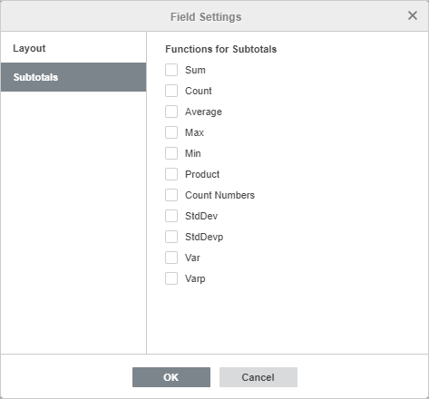

The Subtotals tab allows you to choose Functions for Subtotals. Check the necessary functions in the list: Sum, Count, Average, Max, Min, Product, Count Numbers, StdDev, StdDevp, Var, Varp.

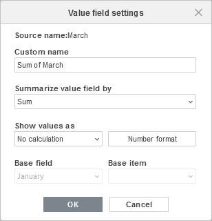

Values field settings
Pivot table Values field settings
  • The Summarize value field by option allows you to choose the function used to calculate the summation value for all values from this field. By default, Sum is used for numeric values, Count is used for text values. The available functions are Sum, Count, Average, Max, Min, Product, Count Numbers, StdDev, StdDevp, Var, Varp.
  • The Show values as option allows you to show instant custom calculations instead of adding a formula and creating a calculated field. No calculation is the default option that displays the actual value in the field. Other calculation options: % of grand total, % of column total, % of row total, % of, % of parent row total, % of parent column total, % of parent total, Difference from, % difference from, Running total in, % running total in, Rank smallest to largest, Rank largest to smallest, Index. Use Base field and Base item when these options are available for the calculation you selected (% of, % of parent total, Difference from, % difference from, Running total in, % running total in).

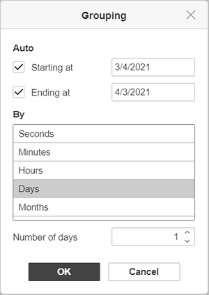

Grouping dates
To group dates, create a pivot table incorporating a set of needed dates. Right click any cell in a pivot table with a date, choose the Group option in the pop-up menu, and set the needed parameters in the opened window.
group dates
  • Starting at - the first date in the source data is chosen by default. To change it, enter the needed date in this field. Deactivate this box to ignore the starting point.
  • Ending at - the last date in the source data is chosen by default. To change it, enter the needed date in this field. Deactivate this box to ignore the ending point.
  • By - the Seconds, Minutes, and Hours options group the data according to the time given in the source data. The Months option eliminates days and leaves months only. The Quarters option operates at a condition: four months constitute a quarter, thus providing Qtr1, Qtr2, etc. The Years option groups dates as per years given in the source data. Combine the options to achieve the needed result.
  • Number of days - set the required value to determine a date range.
  • Click OK when finished.

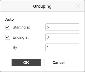

To group numbers, create a pivot table incorporating a set of needed numbers. Right click any cell in a pivot table with a number, choose the Group option in the pop-up menu, and set the needed parameters in the opened window.
group numbers
  • Starting at - the smallest number in the source data is chosen by default. To change it, enter the needed number in this field. Deactivate this box to ignore the smallest number.
  • Ending at - the largest number in the source data is chosen by default. To change it, enter the needed number in this field. Deactivate this box to ignore the largest number.
  • By - set the required interval for grouping numbers. E.g., “2” will group the set of numbers from 1 through 10 as “1-2”, “3-4”, etc.

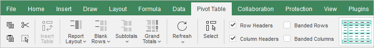

You can use options available on the top toolbar to adjust the way your pivot table is displayed. These options are applied to the entire pivot table.
Select at least one cell within the pivot table with the mouse to activate the editing tools on the top toolbar.

  • The Report Layout drop-down list allows you to choose the necessary layout for your pivot table:
    • Show in Compact Form - allows you to display items from different row section fields in a single column.
      Pivot table Compact form
    • Show in Outline Form - allows you to display the pivot table in the classic pivot table style. It displays one column for each field and provides space for field headers. It also allows you to display subtotals at the top of groups.
      Pivot table Outline form
    • Show in Tabular Form - allows you to display the pivot table in a traditional table format. It displays one column for each field and provides space for field headers.
      Pivot table Tabular form

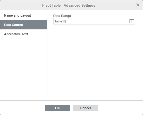

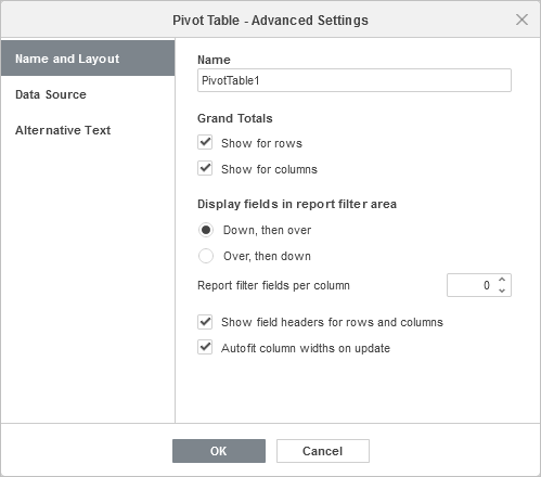

    Note: the similar settings are also available in the pivot table advanced settings window in the Grand Totals section of the Name and Layout tab.

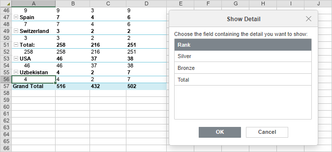

Expand or collapse fields
To expand or collapse data details, click a field with the right mouse button to open the context menu, choose the Expand/Collapse menu item, then select the necessary option:
  • Expand - to show details for the currently selected item.
  • Collapse - to hide details for the currently selected item.
  • Expand Entire Field - to show details for all items in a field. A similar setting is also available at the top toolbar.
  • Collapse Entire Field - to hide details for all items in a field. A similar setting is also available at the top toolbar.
The groups are hidden behind the plus/minus icons. You can also expand/collapse fields by double-clicking the pivot table headers.
The Expand option, when the last field of rows or columns is selected, opens a dialog window for adding a new field to the row or column. Choose the necessary field and click OK.
Pivot Table

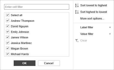

Filtering

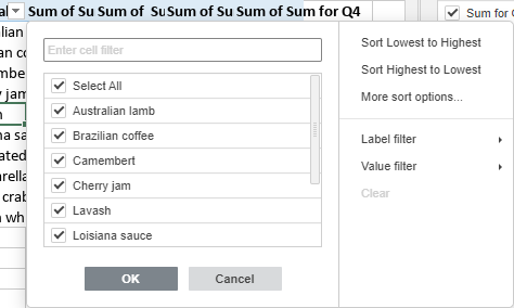

Click the drop-down arrow drop down arrow icon in the Row Labels or Column Labels of the pivot table. The Filter option list will open:
Filter window
Adjust the filter parameters. You can proceed in one of the following ways: select the data to display, or filter the data by certain criteria.
  • Select the data to display
    Uncheck the boxes near the data you need to hide. For your convenience, all the data within the Filter option list are sorted in ascending order.
    Note: the (blank) checkbox corresponds to the empty cells. It is available if the selected cell range contains at least one empty cell.
    To facilitate the process, make use of the search field on the top. Enter your query, entirely or partially, in the field - the values that include these characters will be displayed in the list below. The following two options will also be available:
    • Select All Search Results - is checked by default. It allows selecting all the values that correspond to your query in the list.
    • Add current selection to filter - if you check this box, the selected values will not be hidden when you apply the filter.
    After you select all the necessary data, click the OK button in the Filter option list to apply the filter.

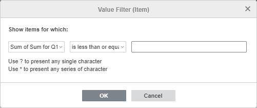

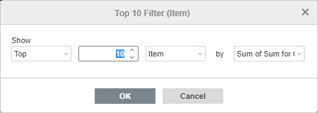

  • Filter data by certain criteria
    You can choose either the Label filter or the Value filter option on the right side of the Filter options list, and then select one of the options from the submenu:
    • For the Label filter the following options are available:
      • For texts: Equals..., Does not equal..., Begins with..., Does not begin with..., Ends with..., Does not end with..., Contains..., Does not contain...
      • For numbers: Greater than..., Greater than or equal to..., Less than..., Less than or equal to..., Between, Not between.
    • For the Value filter the following options are available: Equals..., Does not equal..., Greater than..., Greater than or equal to..., Less than..., Less than or equal to..., Between, Not between, Top 10.
    After you select one of the above options (apart from Top 10), the Label/Value Filter window will open. The corresponding field and criterion will be selected in the first and second drop-down lists. Enter the necessary value in the field on the right.
    Click OK to apply the filter.
    Value Filter window
    If you choose the Top 10 option from the Value filter option list, a new window will open:
    Top 10 AutoFilter window
    The first drop-down list allows choosing if you wish to display the highest (Top) or the lowest (Bottom) values. The second field allows specifying how many entries from the list or which percent of the overall entries number you want to display (you can enter a number from 1 to 500). The third drop-down list allows setting the units of measure: Item, Percent, or Sum. The fourth drop-down list displays the selected field name. Once the necessary parameters are set, click OK to apply the filter.
The Filter filter button icon button will appear in the Row Labels or Column Labels of the pivot table. It means that the filter is applied.
Sorting
You can sort your pivot table data using the sort options. Click the drop-down arrow drop down arrow icon in the Row Labels or Column Labels of the pivot table, and then select Sort Lowest to Highest or Sort Highest to Lowest option from the submenu.
The More Sort Options option allows you to open the Sort window where you can select the necessary sorting order - Ascending or Descending - and then select a certain field you want to sort.
Pivot table sort options

Adjust pivot table advanced settings
To change the advanced settings of the pivot table, use the Show advanced settings link on the right sidebar. The 'Pivot Table - Advanced Settings' window will open:
Pivot table advanced settings
The Name and Layout tab allows you to change the pivot table common properties.
  • The Name option allows you to change the pivot table name.
  • The Grand Totals section allows you to choose if you want to display grand totals in the pivot table. The Show for rows and Show for columns options are checked by default. You can uncheck either one of them or both these options to hide the corresponding grand totals from your pivot table.
    Note: the similar settings are available on the top toolbar in the Grand Totals menu.
  • The Display fields in report filter area section allows you to adjust the report filters which appear when you add fields to the Filters section:
    • The Down, then over option is used for column arrangement. It allows you to show the report filters across the column.
    • The Over, then down option is used for row arrangement. It allows you to show the report filters across the row.
    • The Report filter fields per column option allows you to select the number of filters to go in each column. The default value is set to 0. You can set the necessary numeric value.
  • The Show field headers for rows and columns option allows you to choose if you want to display field headers in your pivot table. The option is enabled by default. Uncheck it to hide field headers from your pivot table.
  • The Autofit column widths on update option allows you to enable/disable automatic adjusting of the column widths. The option is enabled by default.
The Data Source tab allows you to change the data you wish to use to create the pivot table.
Check the selected Data Range and modify it, if necessary. To do that, click the change range icon icon.
In the Select Data Range window, enter the necessary data range in the following format: Sheet1!$A$1:$E$10. You can also select the necessary cell range in the sheet using the mouse. When ready, click OK.

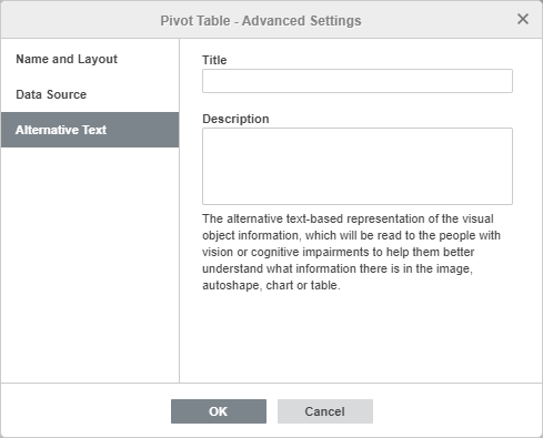

The Alternative Text tab allows specifying the Title and the Description which will be read to people with vision or cognitive impairments to help them better understand what information the pivot table contains.

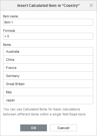

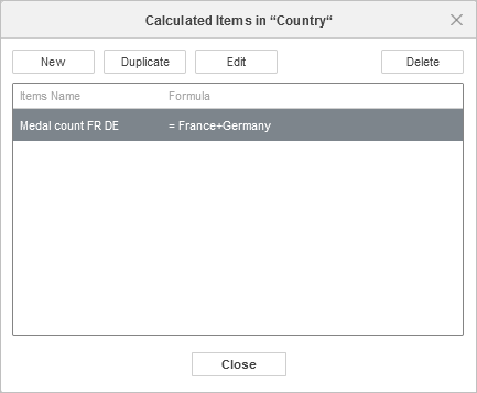

Calculated items
Calculated items are used for basic calculations between different items within a single field.
To add a calculated item:
  1. Select the required field.
  2. Go to the Pivot Table tab and click the Calculated Items button on the top toolbar.
  3. Enter the Item Name, which will be displayed as a pivot table field name later.
    Calculated Items window
  4. Edit the Formula field by typing in the required fields from the list below or by clicking the plus button to the right of them, and entering the required mathematical symbols, e.g., "+" or "-".
  5. Click OK. To further manage created calculated items, use the corresponding buttons at the top of the window: add a new one, duplicated, edit, or delete the currently selected one.
    Calculated Items window for editing
