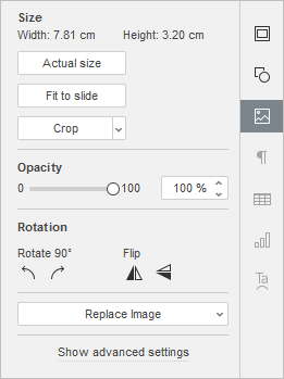

The right sidebar is activated when you left-click an image and choose the Image settings image settings icon icon on the right. It contains the following sections:
Image Settings tab
Size — is used to view the Width and Height of the current image or restore its Actual Size if necessary.
The Crop button is used to crop the image. Click the Crop button to activate cropping handles, which appear on the image corners and in the center of its each side. Manually drag the handles to set the cropping area. You can move the mouse cursor over the cropping area border so that it turns into the arrow icon icon and drag the area.
  • To crop a single side, drag the handle located in the center of this side.
  • To simultaneously crop two adjacent sides, drag one of the corner handles.
  • To equally crop two opposite sides of the image, hold down the Ctrl key when dragging the handle in the center of one of these sides.
  • To equally crop all sides of the image, hold down the Ctrl key when dragging any of the corner handles.
When the cropping area is specified, click the Crop button once again, or press the Esc key, or click anywhere outside the cropping area to apply the changes.
After the cropping area is selected, it's also possible to use the Crop to shape, Fill and Fit options available from the Crop drop-down menu. Click the Crop button once again and select the option you need:
  • If you select the Crop to shape option, the picture will fill a certain shape. You can select a shape from the gallery, which opens when you hover your mouse pointer over the Crop to Shape option. You can still use the Fill and Fit options to choose the way your picture matches the shape.
  • If you select the Fill option, the central part of the original image will be preserved and used to fill the selected cropping area, while other parts of the image will be removed.
  • If you select the Fit option, the image will be resized so that it fits the cropping area height or width. No parts of the original image will be removed, but empty spaces may appear within the selected cropping area.
To return the image to its default pixel dimensions, click the Reset crop button.
Opacity — use this section to set an Opacity level dragging the slider or entering the percent value manually. The default value is 100%. It corresponds to the full opacity. The 0% value corresponds to the full transparency.
Replace Image — is used to load another image instead of the current one from the desired source. You can select one of the options: From File, From Storage, or From URL. The Replace image option is also available in the right-click menu.
Rotation is used to rotate the image by 90 degrees clockwise or counterclockwise, as well as to flip the image horizontally or vertically. Click one of the buttons:
  • rotate counterclockwise icon to rotate the image by 90 degrees counterclockwise
  • rotate clockwise icon to rotate the image by 90 degrees clockwise
  • flip left to right icon to flip the image horizontally (left to right)
  • flip upside down icon to flip the image vertically (upside down)

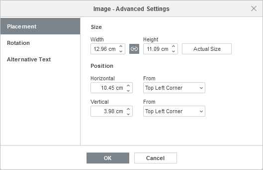

The Placement tab allows you to set the following image properties:
  • Size — use this option to change the image width and/or height. If the Constant proportions constant proportions icon button is clicked (in this case it looks like this constant proportions activated icon), the width and height will be changed together, preserving the original image aspect ratio. To restore the actual size of the added image, click the Actual Size button.
  • Position — set the exact position using the Horizontal and Vertical fields, as well as the From field, where you can access such settings as Top Left Corner and Center.

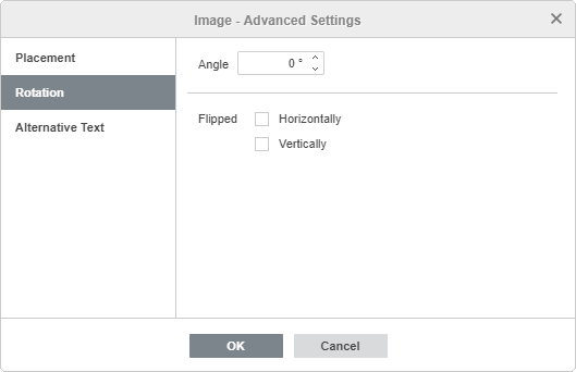

Image Properties: Rotation
The Rotation tab contains the following parameters:
  • Angle — use this option to rotate the image by an exactly specified angle. Enter the necessary value measured in degrees into the field or adjust it using the arrows on the right.
  • Flipped — check the Horizontally box to flip the image horizontally (left to right) or check the Vertically box to flip the image vertically (upside down).

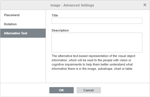

Image Properties
The Alternative Text tab allows specifying the Title and Description which will be read to people with vision or cognitive impairments to help them better understand the contents of the image.
