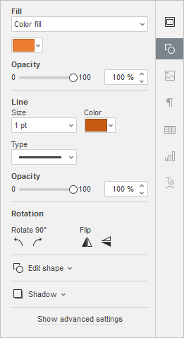

Some of the autoshape settings can be altered using the Shape settings tab of the right sidebar. To activate it, click the autoshape and choose the Shape settings shape settings icon icon on the right. Here, you can change the following properties:
Shape settings tab
  • Fill — use this section to select the autoshape fill. You can choose the following options:
    • Color Fill — to specify the solid color you want to apply to the selected shape.
    • Gradient Fill — to fill the shape with two colors which smoothly change from one to another.
    • Picture or Texture — to use an image or a predefined texture as the shape background.
    • Pattern — to fill the shape with a two-colored design composed of regularly repeated elements.
    • No Fill — select this option if you don't want to use any fill.
    For more detailed information on these options, please refer to the Fill objects and select colors section.
  • Line — use this section to change the width, color or type of the autoshape line.
    • To change the line width, select one of the available options from the Size drop-down list. The available options are: 0.5 pt, 1 pt, 1.5 pt, 2.25 pt, 3 pt, 4.5 pt, 6 pt. Or select the No Line option if you don't want to use any line.
    • To change the line color, click on the colored box below and select the necessary color. You can use the selected theme color, a standard color, or choose a custom color.
    • To change the line type, select the necessary option from the corresponding dropdown list (a solid line is applied by default, you can change it to one of the available dashed lines).
    • To change the line opacity, enter the required value manually or use the corresponding slider bar.
  • Rotation is used to rotate the shape by 90 degrees clockwise or counterclockwise, as well as to flip the shape horizontally or vertically. Click one of the buttons:
    • rotate counterclockwise icon to rotate the shape by 90 degrees counterclockwise
    • rotate clockwise icon to rotate the shape by 90 degrees clockwise
    • flip left to right icon to flip the shape horizontally (left to right)
    • flip upside down icon to flip the shape vertically (upside down)
  • Edit shape — use this section to edit the shape points or to replace the current autoshape with another one selected from the dropdown list.
    • Edit points is used to customize or to change the curvature of your shape.
      1. Once you click the anchor point, two blue lines with white squares at the ends will appear. These are Bézier handles that allow you to create a curve and to change a curve’s smoothness.
        Edit Points
      2. As long as the anchor points are active, you can add and delete them.
        To add a point to a shape, hold Ctrl and click the position where you want to add an anchor point.
        To delete a point, hold Ctrl and click the unnecessary point.
    • Change Shape is used to replace the current autoshape. Choose another autoshape from the dropdown list.
  • Shadow — open this menu to choose one of the preset shadow styles used for the shape.
    • No Shadow — uncheck this menu point to display a shadow, and vice versa.
    • Color — choose one of the available colors either on the Theme colors or the Standard colors palette; use the Eyedropper tool to copy color from other objects in the document; or click the More colors menu item to create a custom color.
    • Adjust Shadow — create a custom shadow using the following sliders:
      Adjust shadow
      • Transparency — adjust the transparency of the shadow.
      • Size — adjust the size of the shadow.
      • Angle — adjust the angle of the shadow relative to its object.
      • Distance — adjust the distance of the shadow from its object.

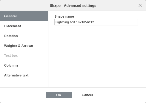

Shape Properties — General tab
General — displays an editable shape name, which can be used for referencing.

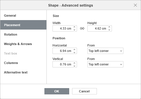

Shape Properties — Size tab
The Placement tab allows you to change the autoshape Width and/or Height. If the Constant proportions constant proportions icon button is clicked (in this case it looks like this constant proportions activated icon), the width and height will be changed together, preserving the original autoshape aspect ratio.
You can also set the exact position using the Horizontal and Vertical fields, as well as the From field, where you can access such settings as Top Left Corner and Center.

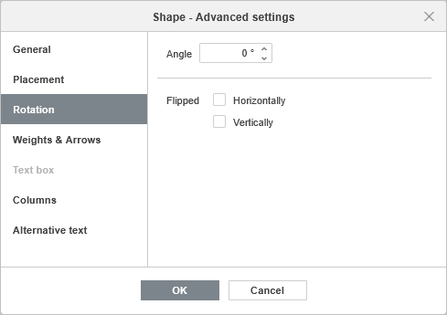

The Rotation tab contains the following parameters:
  • Angle — use this option to rotate the shape by an exactly specified angle. Enter the necessary value measured in degrees into the field or adjust it using the arrows on the right.
  • Flipped — check the Horizontally box to flip the shape horizontally (left to right) or check the Vertically box to flip the shape vertically (upside down).

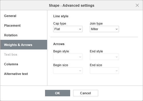

Shape Properties — Weights & Arrows tab
The Weights & Arrows tab contains the following parameters:
  • Line Style — this option allows specifying the following parameters:
    • Cap Type — this option allows setting the style for the end of the line, therefore it can be applied only to the shapes with the open outline, such as lines, polylines, etc.:
      • Flat — the end points will be flat.
      • Round — the end points will be rounded.
      • Square — the end points will be square.
    • Join Type — this option allows setting the style for the intersection of two lines, for example, it can affect a polyline or the corners of the triangle or rectangle outline:
      • Round — the corner will be rounded.
      • Bevel — the corner will be cut off at an angle.
      • Miter — the corner will be pointed. It goes well to shapes with sharp angles.
      Note: the effect will be more noticeable if you use a large outline width.
  • Arrows — this option group is available if a shape from the Lines shape group is selected. It allows you to set the arrow Start and End Style and Size by selecting the appropriate option from the drop-down lists.

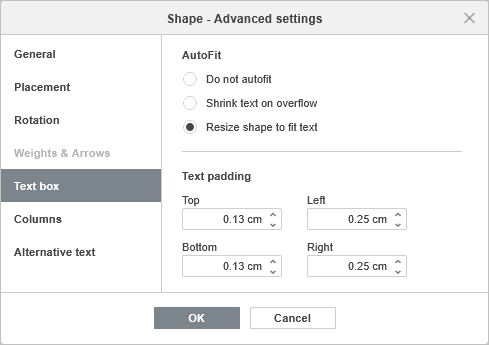

Shape Properties — Text Padding tab
The Text Box tab contains the following parameters:
  • AutoFit — to change the way text is displayed within the shape: Do not Autofit, Shrink text on overflow, Resize shape to fit text.
  • Text Padding — to change the autoshape Top, Bottom, Left and Right internal margins (i.e., the distance between the text within the shape and the autoshape borders).
Note: this tab is only available if text is added within the autoshape, otherwise the tab is disabled.

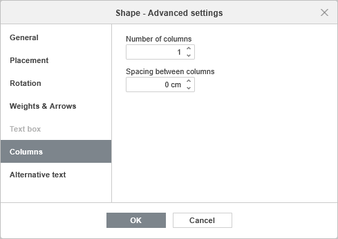

Shape Properties — Columns tab
The Columns tab allows adding columns of text within the autoshape specifying the necessary Number of columns (up to 16) and Spacing between columns. Once you click OK, the text that already exists or any other text you enter within the autoshape will appear in columns and will flow from one column to another.

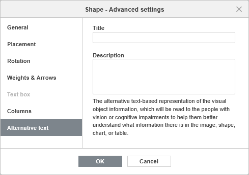

Shape Properties — Alternative Text tab
The Alternative Text tab allows specifying the Title and Description which will be read to people with vision or cognitive impairments to help them better understand the contents of the shape.
