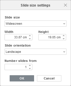

- To change the size of all the slides in the presentation, click the
Select slide size icon on the Design tab of the top toolbar and select the necessary option from the drop-down list. You can select:
- one of the two quick-access presets - Standard (4:3) or Widescreen (16:9),
the Advanced Settings option that opens the Slide Size Settings window where you can select one of the available presets or set a Custom size specifying the desired Width and Height values.
The available presets are: Standard (4:3), Widescreen (16:9), Widescreen (16:10), Letter Paper (8.5x11 in), Ledger Paper (11x17 in), A3 Paper (297x420 mm), A4 Paper (210x297 mm), B4 (ICO) Paper (250x353 mm), B5 (ICO) Paper (176x250 mm), 35 mm Slides, Overhead, Banner.
The Slide Orientation menu allows changing the currently selected orientation type. The default orientation type is Landscape that can be switched to Portrait.
The Number slides from field allows setting the slide that will mark the start of slide numeration.

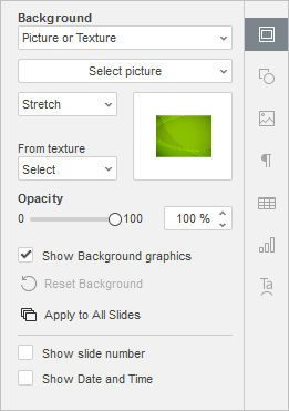

- To change a background fill:
- in the slide list on the left, select the slides you want to apply the fill to. Or click on any blank space within the currently edited slide in the slide editing area to change the fill type for this separate slide.
on the Slide settings tab of the right sidebar, select the necessary option:
- Color Fill - select this option to specify the solid color you want to apply to the selected slides.
- Gradient Fill - select this option to fill the slide with two colors, which smoothly change from one to another.
- Picture or Texture - select this option to use an image or a predefined texture as the slide background.
- Pattern - select this option to fill the slide with a two-colored design composed of regularly repeated elements.
- No Fill - select this option if you don't want to use any fill.
- Opacity - drag the slider or enter the percent value manually. The default value is 100%. It corresponds to the full opacity. The 0% value corresponds to the full transparency.
- Show Background graphics - uncheck this menu item to simplify the background and improve presentation loading time due to lower graphics settings.
- Reset Background - reset background to default.
- Apply to All Slides - apply the current background to all slides in the presentation.

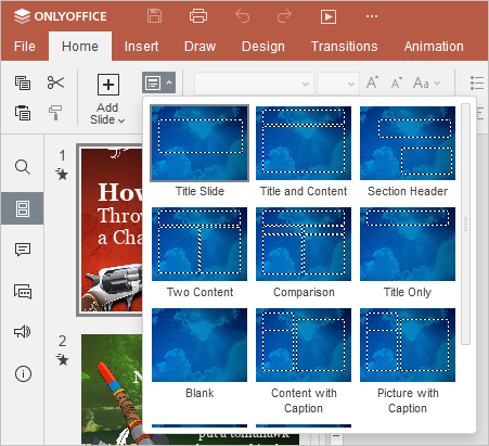

To change a slide layout:
- in the slide list on the left, select the slides you want to apply a new layout to,
- click the
Change slide layout icon on the Home or Design tab of the top toolbar, -
select the necessary layout from the menu.
Alternatively, you can right-click the necessary slide in the list on the left or in the editing area, select the Change Layout option from the contextual menu and choose the necessary layout.
Currently, the following layouts are available: Title Slide, Title and Content, Section Header, Two Content, Comparison, Title Only, Blank, Content with Caption, Picture with Caption, Title and Vertical Text, Vertical Title and Text.

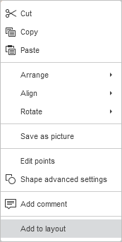

To add objects to a slide layout:
- click the Change slide layout
icon and select a layout you want to add an object to, -
using the Insert tab of the top toolbar, add the necessary object to the slide (image, table, chart, shape), then right-click on this object and select Add to Layout option,
on the Home tab, click Change slide layout
and apply the changed layout.
The selected objects will be added to the current theme's layout.
Objects placed on a slide this way cannot be selected, resized, or moved.
