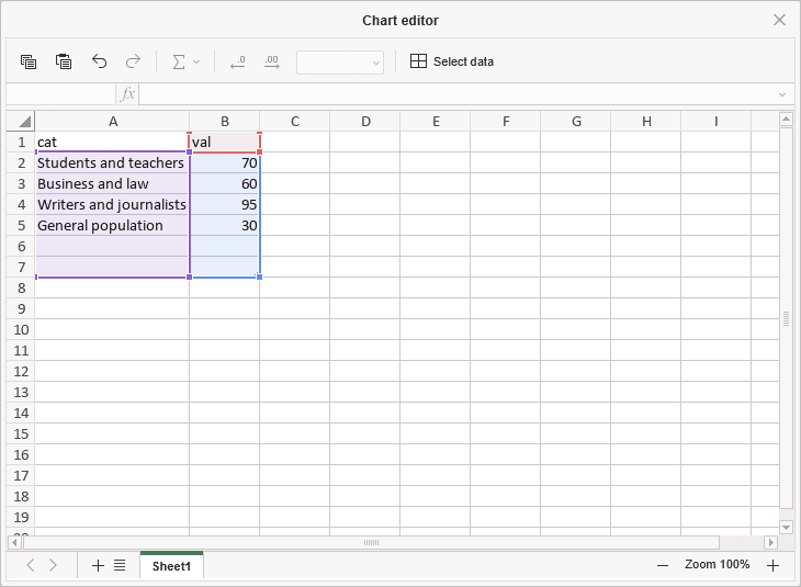

After that, the Chart Editor window will appear where you can enter the necessary data into the cells using the following controls:
and
for copying and pasting the copied data
and
for undoing and redoing actions
for inserting a function
and
for decreasing and increasing decimal places
for changing the number format, i.e., the way the numbers you enter appear in cells
Click the Select Data button situated in the Chart Editor window. The Chart data window will open.
Use the Chart data dialog to manage Chart data range, Legend entries (series), Horizontal (category) axis labels and Switch row/column.

The Edit Data button allows you to open the Chart Editor window and start editing data as described above.
Note: to quickly open the 'Chart Editor' window, you can also double-click the chart on the slide.
