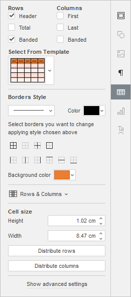

Most of the table properties as well as its structure can be altered by using the right sidebar. To activate it, click the table and choose the Table settings table settings icon icon on the right.
The Rows and Columns sections on the top allow you to emphasize certain rows/columns by applying a specific formatting to them, or highlight different rows/columns with different background colors to clearly distinguish them. The following options are available:
  • Header - emphasizes the topmost row in the table with special formatting.
  • Total - emphasizes the bottommost row in the table with special formatting.
  • Banded - enables the background color alternation for odd and even rows.
  • First - emphasizes the leftmost column in the table with special formatting.
  • Last - emphasizes the rightmost column in the table with special formatting.
  • Banded - enables the background color alternation for odd and even columns.
The Select From Template section allows you to choose one of the predefined tables styles. Each template combines certain formatting parameters, such as a background color, border style, row/column banding etc. Depending on the options checked in the Rows and/or Columns sections above, the templates set will be displayed differently. For example, if you've checked the Header option in the Rows section and the Banded option in the Columns section, the displayed templates list will include only templates with the header row and banded columns enabled:
big templates
The Borders Style section allows you to change the applied formatting that corresponds to the selected template. You can select the entire table or a certain cell range and set all the parameters manually.
  • Border parameters - set the border width using the border size list (or choose the No borders option), select its Color in the available palettes and determine the way it will be displayed in the cells when clicking on the icons:
    border type
  • Background color - select the color for the background within the selected cells.
The Rows & Columns rows and columns icon section allows you to perform the following operations:
  • Select a row, column, cell (depending on the cursor position), or the entire table.
  • Insert a new row above or below the selected one, as well as a new column to the left or to the right of the selected one.
  • Delete a row, column (depending on the cursor position or the selection), or the entire table.
  • Merge Cells - to merge previously selected cells into a single one.
  • Split Cell... - to split any previously selected cell into a certain number of rows and columns. This option opens the following window:
    Split Cells window
    Enter the Number of Columns and Number of Rows that the selected cell should be split into and press OK.
Note: the options of the Rows & Columns section are also accessible from the right-click menu.
The Cell Size section is used to adjust the width and height of the currently selected cell. In this section, you can also Distribute rows so that all the selected cells are of equal height or Distribute columns so that all the selected cells are of equal width. The Distribute rows/columns options are also accessible from the right-click menu.

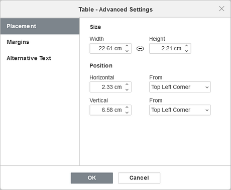

The Placement tab allows you to set the following table properties:
  • Size - use this option to change the table width and/or height. If the Constant proportions constant proportions icon button is clicked (in this case it looks like this constant proportions activated icon), the width and height will be changed together, preserving the original image aspect ratio.
  • Position - set the exact position using the Horizontal and Vertical fields, as well as the From field, where you can access such settings as Top Left Corner and Center.

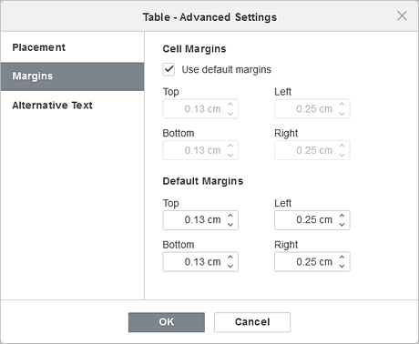

The Margins tab allows setting the space between the text within the cells and the cell border:
  • enter necessary Cell Margins values manually, or
  • check the Use default margins box to apply the predefined values (if necessary, they can also be adjusted).

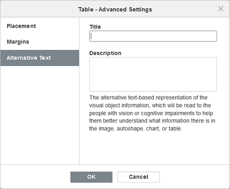

The Alternative Text tab allows specifying the Title and Description which will be read to people with vision or cognitive impairments to help them better understand the contents of the table.
