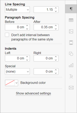

  • set the necessary parameters on the right sidebar Paragraph settings in the Indents section:
    • Left - set the paragraph offset from the left side of the page, specifying the necessary numeric value,
    • Right - set the paragraph offset from the right side of the page, specifying the necessary numeric value,
    • Special - set an indent for the first line of the paragraph: select the corresponding menu item ((none), First line, Hanging) and change the default numeric value specified for First Line or Hanging,
