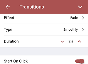

  3. tap the Transition menu item,
  4. tap the Effect menu item and select the necessary transition,
    Transition panel
    The following transitions and their types are available:
    • Fade - Smoothly, Through black
    • Push - Left, Top, Right, Bottom;
    • Wipe - Left, Top, Right, Bottom, Top left, Top right, Bottom left, Bottom right;
    • Split - Vertical in, Vertical out, Horizontal in, Horizontal out;
    • Unover - Left, Top, Right, Bottom, Top left, Top right, Bottom left, Bottom right;
    • Cover - Left, Top, Right, Bottom, Top left, Top right, Bottom left, Bottom right;
    • Clock - Clockwise, Counterclockwise, Wedge;
    • Zoom - Zoom in, Zoom out, Zoom and rotate.
    Use the Return arrow on the left to return to the previous settings section.
  5. tap the Type menu item to select one of the available effect options. They define exactly how the effect appears. For example, if the Zoom transition is selected, the Zoom In, Zoom Out and Zoom and Rotate options are available.
  6. the Duration section allows to specify how long you want the transition to last. Set the necessary time value, measured in seconds.
    The default transition duration value is 2 s. Use the Downwards arrow or Upwards arrow arrows to decrease or increase the current value.
