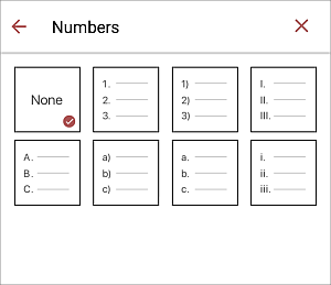

  4. select the list type you would like to start:
    • tap the Bullets option to create an Unordered list with markers and select the marker type,
    • tap the Numbers option to create an Ordered list with digits or letters and select how the list is going to look like.
    Paragraph List settings
  5. return to the previous screen by tapping the Back arrow on the left and сlose the text settings panel by tapping the Back icon on the right.
  6. now each time you press the Enter key Enter key at the end of the line a new ordered or unordered list item will appear. To stop that, tap the Backspace key key and continue with the common text paragraph.
