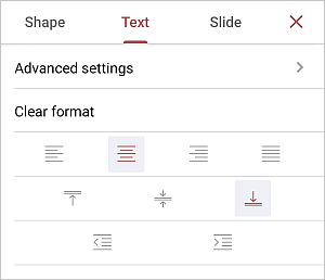

Select the text you want the alignment to be applied to and open the settings panel by:
- tapping the
icon at the top or bottom toolbar, or - tapping the
option in the pop-up menu,
Switch to the Text tab and swipe up to see all the settings.
Tap the necessary horizontal alignment type to apply:
- tap the
icon to line up the text by the left side of the text box (the right side remains unaligned). - tap the
icon to line up the text by the center of the text box (the right and the left sides remains unaligned). - tap the
icon to line up the text by the right side of the text box (the left side remains unaligned). - tap the
icon to line up the text by both the left and the right sides of the text box (additional spacing is added where necessary to keep the alignment).
Tap the necessary vertical alignment type to apply:
- tap the
icon to align your text to the top of the text box - tap the
icon to align your text to the middle of the text box - tap the
icon to align your text to the bottom of the text box
To change the first line offset from the left part of the text box, use the respective icons: Decrease Indent
and Increase Indent
To clear applied formatting, you can use the Clear format option.
Close the text settings panel by tapping the
icon on the right.
