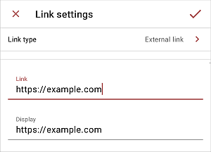

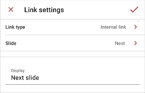

- after that the Link settings screen will appear where you can specify the hyperlink parameters:
- Link type - select a link type you wish to insert:
- External link - this option is selected by default. Use it to add a hyperlink leading to an external website. Enter a URL in the format http://www.example.com in the Link field below.
- Internal link - use this option to add a hyperlink leading to a certain slide in the same presentation. Tap this option to select it, then return to the previous screen using the
arrow on the left. Select the necessary Slide from the list: Next, Previous, First, Last, or a certain slide number.
- Display - enter a text that will get clickable and lead to the address/slide specified in the upper field.
If you've selected a text passage before tapping the
icon, the Display field will be filled with the selected text fragment.
- tap the checkmark in the upper right corner.
