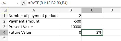

Examples
The figure below displays the result returned by the RATE function.
