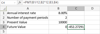

Examples
The figure below displays the result returned by the PMT function.
