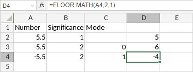

Examples
The figure below displays the result returned by the FLOOR.MATH function.
