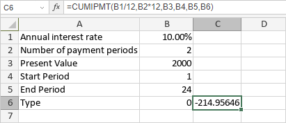

The figure below displays the result returned by the CUMIPMT function.
CUMIPMT Function
