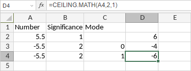

Examples
The figure below displays the result returned by the CEILING.MATH function.
