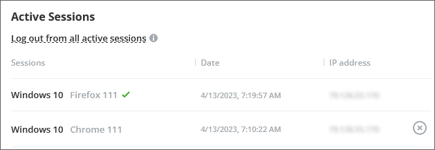

  1. Click the Options icon icon next to your name in the lower left corner and select the Profile option or just click your name.
  2. On the My profile page, find the Active Sessions section. You will see the list of all your active connections which contains the following data: operating system, browser, date and time, IP address. In the SaaS version, the country and city are also displayed.
    Active connections list
  3. Find the needed connection and click on the Close section icon icon located on the right.
  4. Click Log out to confirm the action.
    Closing a particular session
The selected connection will be stopped and excluded from the list.

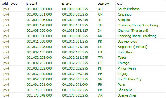

To determine the location by IP address, you need to fill in the `dbip_lookup` table with data in the database.
The table has a specific data format.
To display location in the Active connections section, it's necessary to fill in the following columns:
  • `addr_type` - the type of the IP address.
  • `ip_start` - the beginning of the IP addresses range.
  • `ip_end` - the end of the IP addresses range.
  • `country` - the country code in the ISO-3166-alpha2 format.
  • `city` - the locality name.
The type of the IP address has two possible values: "ipv4" or "ipv6".
The IP addresses range is specified in an extended format containing empty positions:
  • "127.0.0.1" must be extended to "127.000.000.001";
  • "::1" must be extended to "0000:0000:0000:0000:0000:0000:0000:0001".
The country code is specified as a two-letter abbreviation (e.g., "AU", "US", "JP", etc.) The "ZZ" value is ignored (Unknown or unspecified country).
