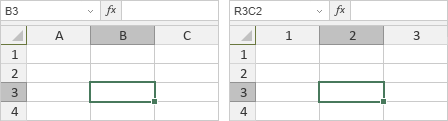

    When the A1 reference style is used, columns are designated by letters, and rows are designated by numbers. If you select the cell located in row 3 and column 2, its address displayed in the box to the left of the formula bar looks like this: B3. If the R1C1 reference style is enabled, both rows and columns are designated by numbers. If you select the cell at the intersection of row 3 and column 2, its address will look like this: R3C2. Letter R indicates the row number and letter C indicates the column number.

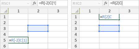

    In case you refer to other cells using the R1C1 reference style, the reference to a target cell is formed based on the distance from an active cell. For example, when you select the cell in row 5 and column 1 and refer to the cell in row 3 and column 2, the reference is R[-2]C[1]. The numbers in square brackets designate the position of the cell relative to the current cell position, i.e., the target cell is 2 rows up and 1 column to the right of the active cell. If you select the cell in row 1 and column 2 and refer to the same cell in row 3 and column 2, the reference is R[2]C, i.e., the target cell is 2 rows down from the active cell and in the same column.
    relative reference
