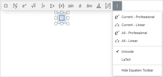

    The following categories are currently available: Symbols, Fractions, Scripts, Radicals, Integrals, Large Operators, Brackets, Functions, Accents, Limits and Logarithms, Operators, Matrices,
  5. click the Equation Settings symbol in the toolbar above the inserted equation to access more settings, e.g., Unicode or LaTeX, Professional or Linear,
  6. click the certain symbol/equation in the corresponding set of templates,
  7. to hide the toolbar, click the Hide Equation Toolbar option in the Equation Settings.
equation toolbar
The selected symbol/equation box will be inserted in the center of the current slide.
inserted equation

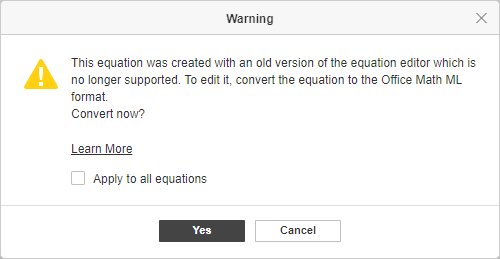

Convert equations
If you open an existing document containing equations which were created with an old version of equation editor (for example, with MS Office versions before 2007), you need to convert these equations to the Office Math ML format to be able to edit them.
To convert an equation, double-click it. The warning window will appear:
Convert equation
To convert the selected equation only, click the Yes button in the warning window. To convert all equations in this document, check the Apply to all equations box and click Yes.
Once the equation is converted, you can edit it.
