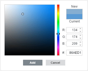

  • You can also apply a custom color using two different options:
    • Eyedropper - use this option to choose the required color by clicking it in the document.
    • More colors - click this option if the required color is missing among the available palettes.
      • Select the necessary color range moving the vertical color slider and set a specific color dragging the color picker within the large square color field.
      • Once you select a color with the color picker, the appropriate RGB and sRGB color values will be displayed in the fields on the right.
      • You can also define a color on the base of the RGB color model by entering the corresponding numeric values into the R, G, B (red, green, blue) fields or enter the sRGB hexadecimal code into the field marked with the # sign.
      • The selected color appears in the New preview box.
      • If the object was previously filled with any custom color, this color is displayed in the Current box so you can compare the original and modified colors.
      • When the color is defined, click the Add button:
      Palette - Custom Color
      The custom color will be applied to the selected element and added to the Recent colors palette.
