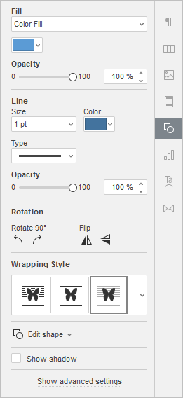

Shape settings tab
Some shape settings can be altered using the Shape settings tab on the right sidebar. To activate it, click the shape and choose the shape settings icon Shape settings icon on the right.
Fill
Use this section to select the shape fill. You can choose the following options:
  • Color Fill — select this option to specify the solid color to fill the inner space of the selected shape.
    Color Fill
    Click the colored box below and select the necessary color from the available color sets or specify any color you like.

Shape Settings tab
Opacity
Use this section to set an Opacity level by dragging the slider or entering the percent value manually. The default value is 100%. It corresponds to the full opacity. The 0% value corresponds to the full transparency.
Line
Use this section to change the width, color, or type of the shape line.
  • To change the line width, select one of the available options from the Size dropdown list. The available options are 0.5 pt, 1 pt, 1.5 pt, 2.25 pt, 3 pt, 4.5 pt, 6 pt. Alternatively, select the No Line option if you don't want to use any line.
  • To change the line color, click on the colored box below and select the necessary color.
  • To change the line type, select the necessary option from the corresponding dropdown list (a solid line is applied by default; you can change it to one of the available dashed lines).
  • To change the line opacity, enter the required value manually or use the corresponding slider bar.
Rotation
Use this section to rotate the shape by 90 degrees clockwise or counterclockwise, as well as to flip the shape horizontally or vertically. Click one of the buttons:
  • rotate counterclockwise icon to rotate the shape by 90 degrees counterclockwise.
  • rotate clockwise icon to rotate the shape by 90 degrees clockwise.
  • flip left to right icon to flip the shape horizontally (left to right).
  • flip upside down icon to flip the shape vertically (upside down).
Wrapping Style
Use this section to select a text wrapping style from the available ones: inline, square, tight, through, top and bottom, in front, behind. For more information, see the advanced settings description below.

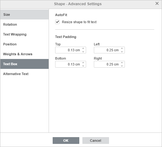

Adjust shape advanced settings
To change the advanced settings of the shape, right-click it and select the Advanced Settings option in the menu, or use the Show advanced settings link on the right sidebar. The 'Shape — Advanced Settings' window will open:

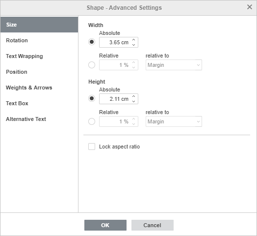

The Size tab contains the following parameters:
  • Width — use one of these options to change the shape width.
    • Absolute — specify an exact value measured in absolute units, i.e., Centimeters/Points/Inches (depending on the option specified on the FileAdvanced Settings... tab).
    • Relative — specify a percentage relative to the left margin width, the margin (i.e., the distance between the left and right margins), the page width, or the right margin width.
  • Height — use one of these options to change the shape height.
    • Relative — specify a percentage relative to the margin (i.e., the distance between the top and bottom margins), the bottom margin height, the page height, or the top margin height.
  • If the Lock aspect ratio option is checked, the width and height will be changed together, preserving the original shape aspect ratio.

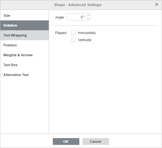

The Rotation tab contains the following parameters:
  • Angle — use this option to rotate the shape by an exactly specified angle. Enter the necessary value measured in degrees into the field or adjust it using the arrows on the right.
  • Flipped — check the Horizontally box to flip the shape horizontally (left to right) or check the Vertically box to flip the shape vertically (upside down).

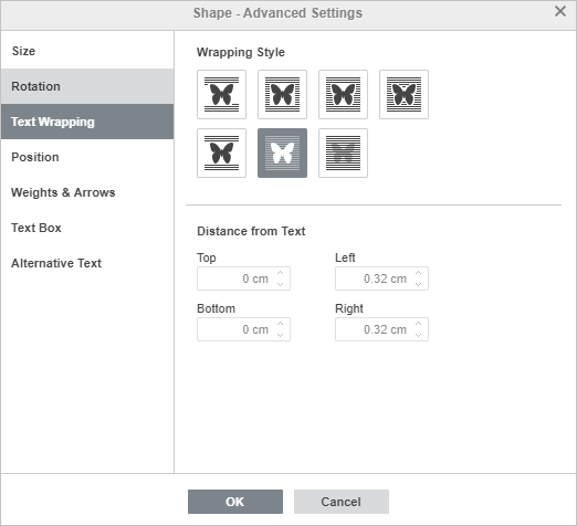

The Text Wrapping tab contains the following parameters:
  • Wrapping Style — use this option to change the way the shape is positioned relative to the text: it will either be a part of the text (in case you select the inline style) or bypassed by it from all sides (if you select one of the other styles).
    • wrapping style inline Inline — the shape is considered to be a part of the text, like a character, so when the text moves, the shape moves as well. In this case, the positioning options are inaccessible.
      If one of the following styles is selected, the shape can be moved independently of the text and positioned on the page exactly:
    • wrapping style square Square — the text wraps the rectangular box that bounds the shape.
    • wrapping style tight Tight — the text wraps the actual shape edges.
    • wrapping style through Through — the text wraps around the shape edges and fills in the open white space within the shape. So that the effect can appear, use the Edit Wrap Boundary option from the right-click menu.
    • wrapping style top and bottom Top and bottom — the text is only above and below the shape.
    • wrapping style in front In front — the shape overlaps the text.
    • wrapping style behind Behind — the text overlaps the shape.
If you select the square, tight, through, or top and bottom styles, you will be able to set up some additional parameters, i.e., distance from text on all sides (top, bottom, left, right).

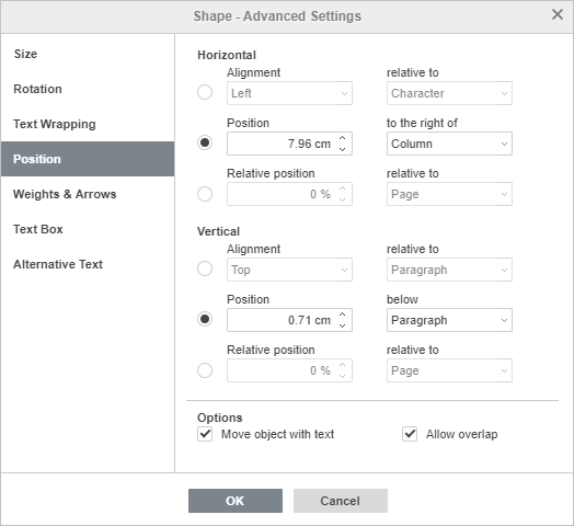

The Position tab is available only if the selected wrapping style is not inline. This tab contains the following parameters that vary depending on the selected wrapping style:
  • The Horizontal section allows you to select one of the following three shape positioning types:
    • Alignment (left, center, right) relative to the character, column, left margin, margin, page, or right margin.
    • Absolute Position measured in absolute units, i.e., Centimeters/Points/Inches (depending on the option specified on the FileAdvanced Settings... tab) to the right of character, column, left margin, margin, page, or right margin.
    • Relative position measured in percent relative to the left margin, margin, page or right margin.
  • The Vertical section allows you to select one of the following three shape positioning types:
    • Alignment (top, center, bottom) relative to the line, margin, bottom margin, paragraph, page, or top margin.
    • Absolute Position measured in absolute units, i.e., Centimeters/Points/Inches (depending on the option specified on the FileAdvanced Settings... tab) below the line, margin, bottom margin, paragraph, page or top margin.
    • Relative position measured in percent relative to the margin, bottom margin, page, or top margin.
  • Move object with text ensures that the shape moves along with the text to which it is anchored.
  • Allow overlap makes it possible for two shapes to overlap if you drag them near each other on the page.

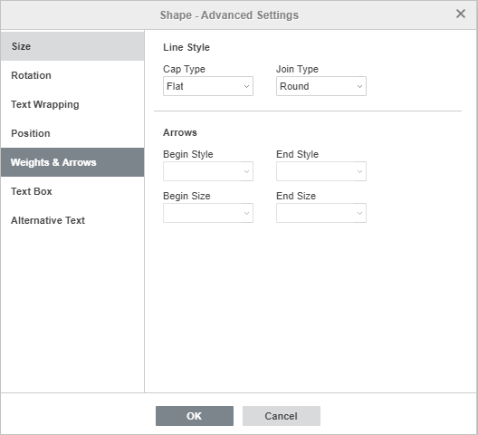

The Weights & Arrows tab contains the following parameters:
  • Line Style — this option group allows specifying the following parameters:
    • Cap Type — this option allows setting the style for the end of the line; therefore, it can be applied only to the shapes with the open outline, such as lines, polylines, etc.:
      • Flat — the end points will be flat.
      • Round — the end points will be rounded.
      • Square — the end points will be square.
    • Join Type — this option allows setting the style for the intersection of two lines, for example, it can affect a polyline or the corners of the triangle or rectangle outline:
      • Round — the corner will be rounded.
      • Bevel — the corner will be cut off at an angle.
      • Miter — the corner will be pointed.
      The effect will be more noticeable if you use a larger outline width.
  • Arrows — this option group is available if a shape from the Lines shape group is selected. It allows setting the arrow Start and End Style and Size by selecting the appropriate option from the dropdown lists.
The Text box tab allows changing the Top, Bottom, Left and Right internal margins of the shape (i.e., the distance between the text within the shape and the shape borders).
This tab is only available if text is added within the shape; otherwise, the tab is disabled.

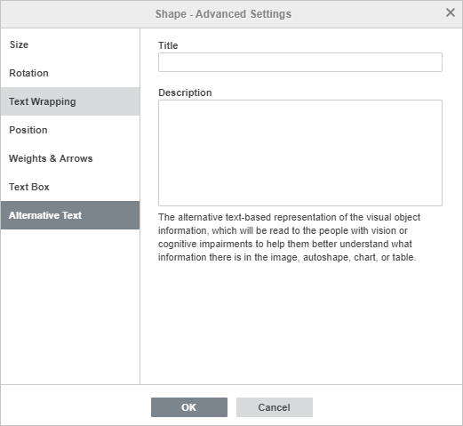

The Alternative Text tab allows specifying a Title and Description that will be read to people with vision or cognitive impairments.
