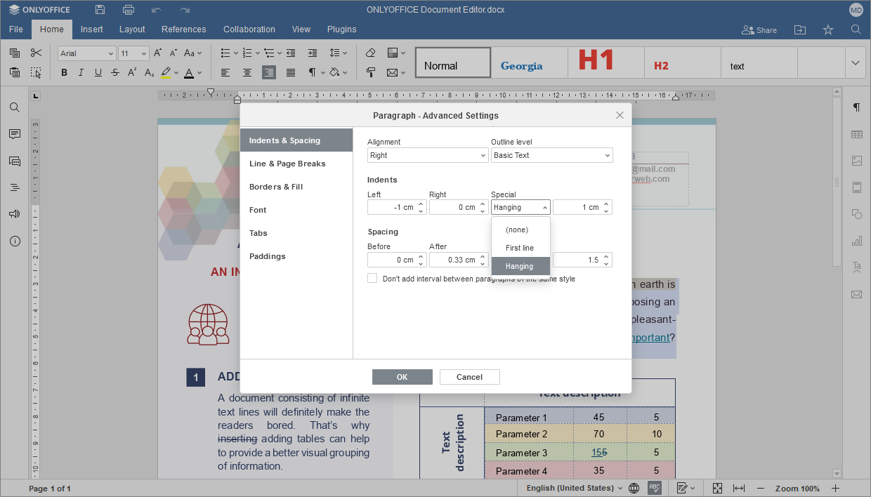

Step 2. Set the hanging indent using paragraph settings
To open the paragraph settings window, right-click the text and select the Paragraph Advanced Settings option from the menu, or use the Show advanced settings link at the right sidebar.
  1. In the opened Paragraph - Advanced Settings window, switch to the Indents & Spacing tab.
  2. In the Indents section, open the Special drop-down list and select the Hanging menu item.
  3. If necessary, change the default numeric value specified for Hanging using the entry field on the right. By default, the 1.27 cm value is used.
  4. Click the OK button to apply the changes.
How to do a hanging indent Step 2 How to do a hanging indent Step 2
