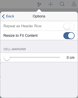

The Table Options section contains the following options:
- Repeat as Header Row - is used to insert the same header row at the top of each page in long tables.
- Resize to Fit Contents - enables automatic change of each column width in accordance with the text within its cells.
- Cell Margins - the space between the text within the cells and the cell border used by default. The value can be altered by dragging the slider.

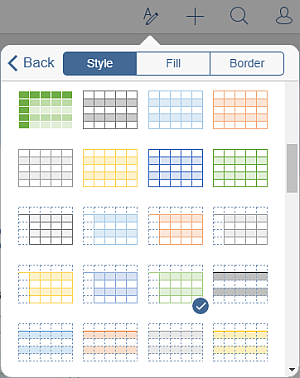

The Style section contains the following three tabs:
- Style - to change the selected preformatted table template. Swipe up to see more templates.

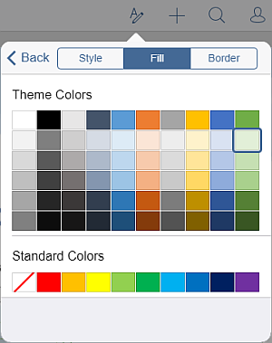

- Fill - to choose a solid color for the table background. Select the necessary color on the Theme Colors or the Standard Colors palette.

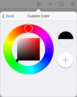

To add a new Custom Color, follow these steps:
- go to the Add Custom Color menu,
- using the color palette, choose the necessary color and select its hue level,
- tap the
button to apply the color to the selected autoshape.
The added color will also be placed in the Custom Colors section, where the recently used custom colors are located.

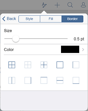

- Border - to set the border Size by dragging the slider, select its Color on the palette and choose the way it will be displayed in the cells by tapping one of the icons:
