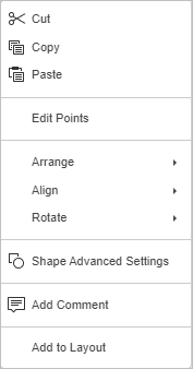

  1. To activate a shape’s editable anchor points, right-click the shape and choose Edit Points from the menu. The black squares that become active are the points where two lines meet, and the red line outlines the shape. Click and drag it to reposition the point, and to change the shape outline.
    Edit Points Menu
