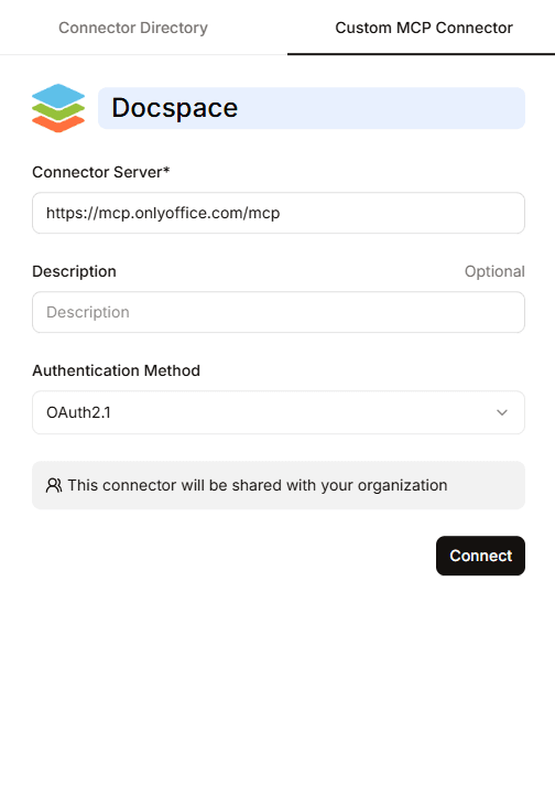

To add the ONLYOFFICE DocSpace MCP Server connector to Mistral:
- Access your Mistral Chat account.

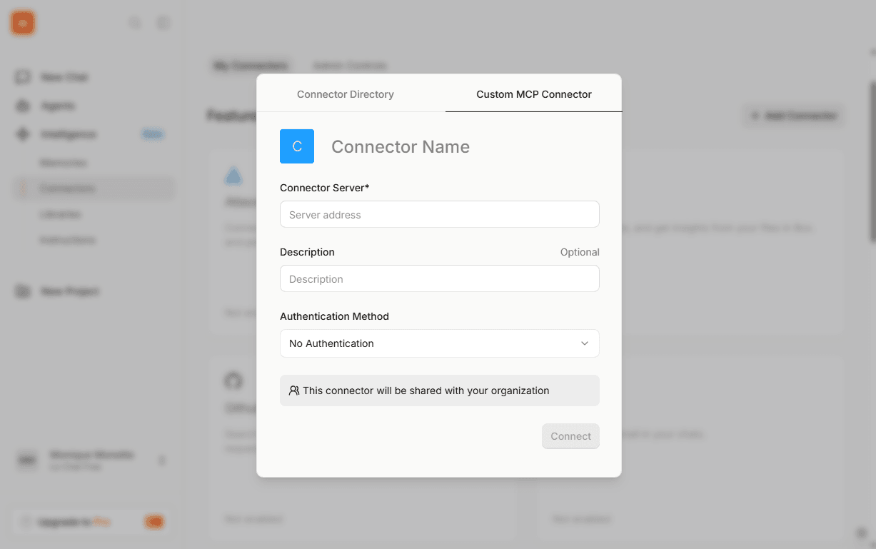

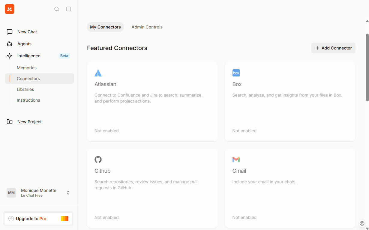

- Go to Intelligence –> Connectors in the left panel and click the Add connector button.
- Choose Custom MCP Connector in the upper right corner and configure the MCP server parameters:
Oath Authentication
- Type in the connector name.
- Connector Server - paste the ONLYOFFIVE MCP Server URL:
https://mcp.onlyoffice.com/mcp - Description – give a short desription for the MCP Server to improve the server identificaton. It’s an optional parameter.
- Authorization Method - choose the Oath2.1 as a method of authorization for the DocSpace MCP Server and click Connect.

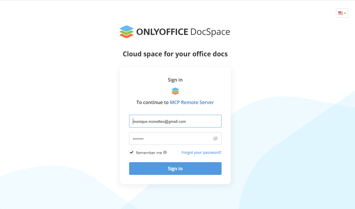

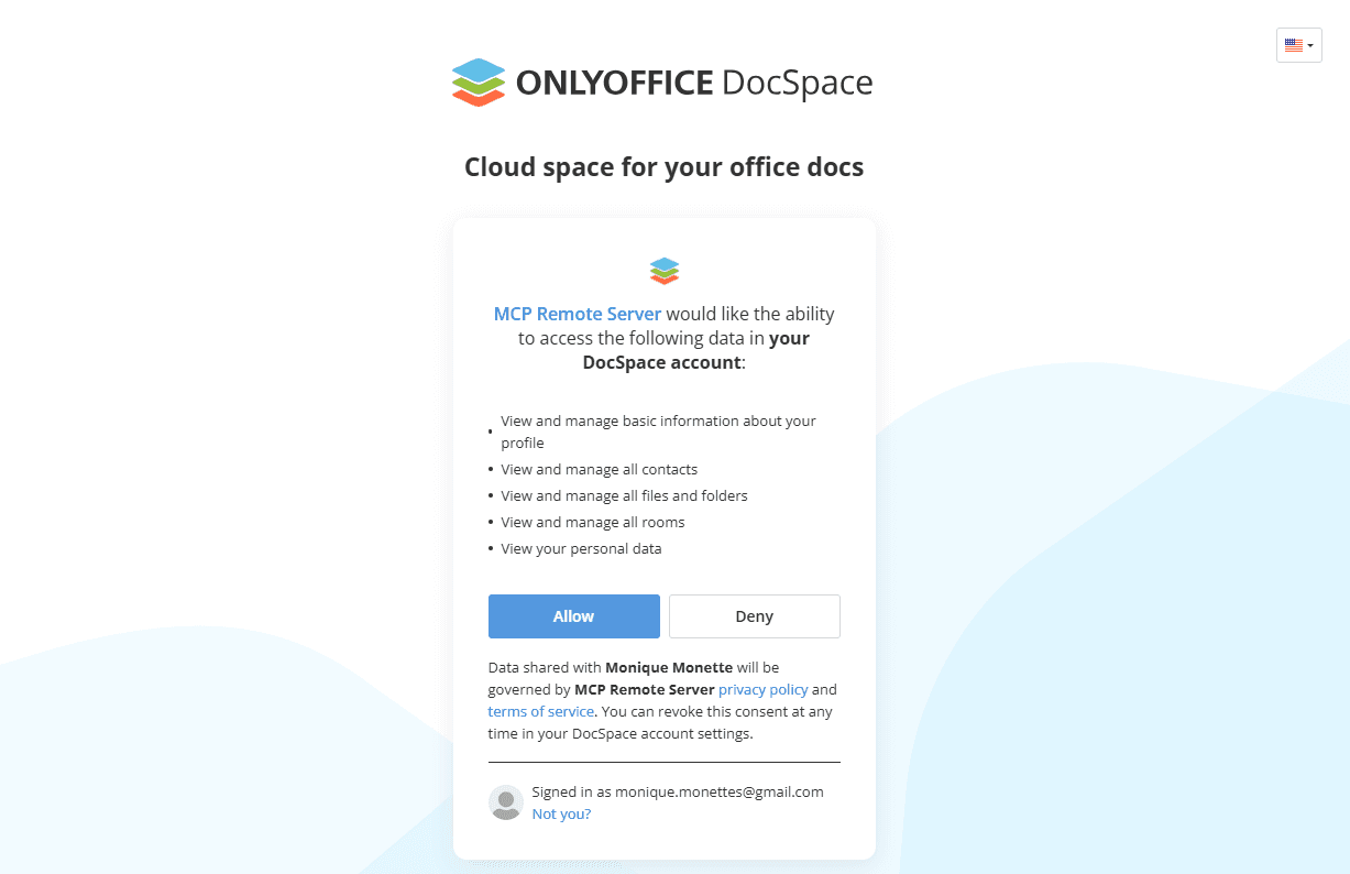

- Complete the OAuth authentication process
- Fill in your DocSpace credentials.
- Allow the MCP Remote Server to access your DocSpace account.

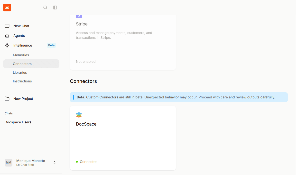

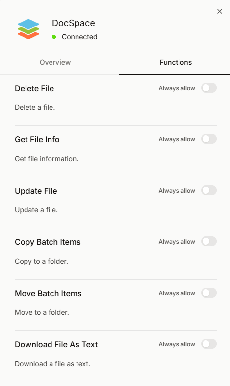

- After a successful authentication, DocSpace connector appears among the available connectors.

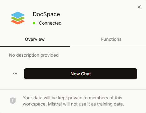

- Click it to to display the connector overview and functions. The Overview tab gives the description of the connector you provided upon the setup, and the possibility to delete the connector clicking the ellipsis.
- The Functions tab allows you to scroll through the available tools, and to enable the necessary ones.

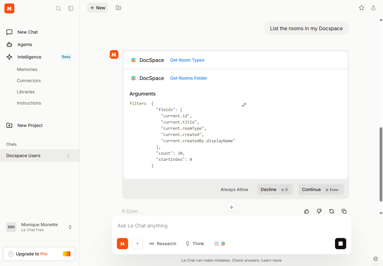

- Open the chat and give your prompt. In the Connectors list, make sure DocSpace (or the name you assigned to it) is selected.
- Click Continue to confirm the list of tools used to respond to your prompt.
