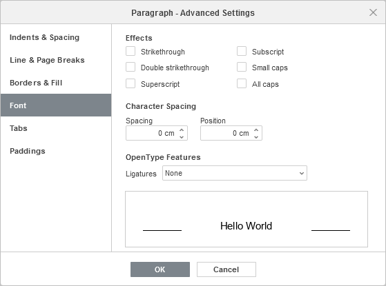

To access the advanced font settings, click the right mouse button and select the Paragraph Advanced Settings option from the menu, or use the Show advanced settings link on the right sidebar. Then the Paragraph - Advanced Settings window will appear, and you will need to switch to the Font tab.
Here, you can use the following font decoration styles and settings:

    All the changes will be displayed in the preview field below.
Paragraph Advanced Settings - Font
