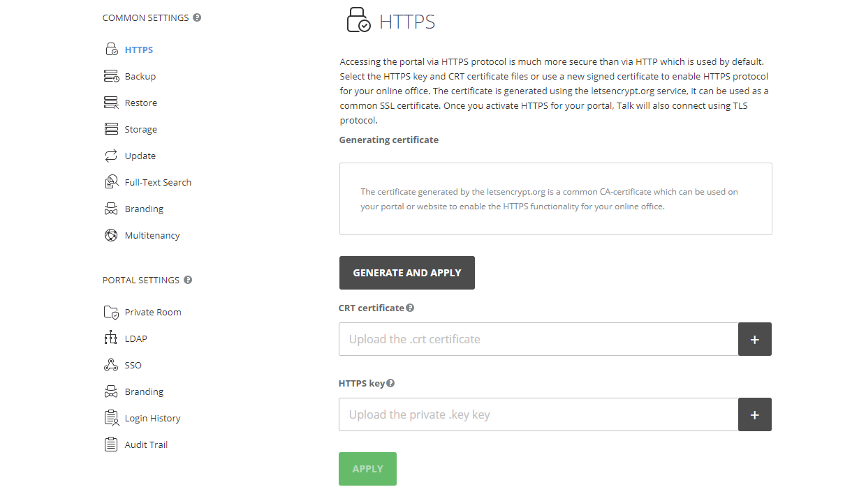

Generate a new certificate
To generate a new certificate:
- Open the HTTPS page in the COMMON SETTINGS section on the left sidebar.
- Click the GENERATE AND APPLY button. A popup message box will appear informing you that the certificate and private key are successfully generated.

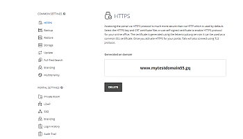

- After that your Control Panel and portal will be restarted and become unavailable during this process. It can take up to 5 minutes. Once the certificate installation process is over, your portal will be available over HTTPS.
To remove the installed certificate, use the DELETE button.
Upload an existing certificate and private key
To use an existing .crt certificate and private .key key:
- Click the Plus button next to the CRT certificate field and select your .crt certificate to upload it.
- Click the Plus button next to the HTTPS key field and select your private .key key to upload it.
Before uploading, please make sure that the private key is not encrypted. If you have a password-protected .key file, you will need to decrypt it first.
- Once the .crt and .key files are uploaded, click the APPLY button at the bottom of the page.

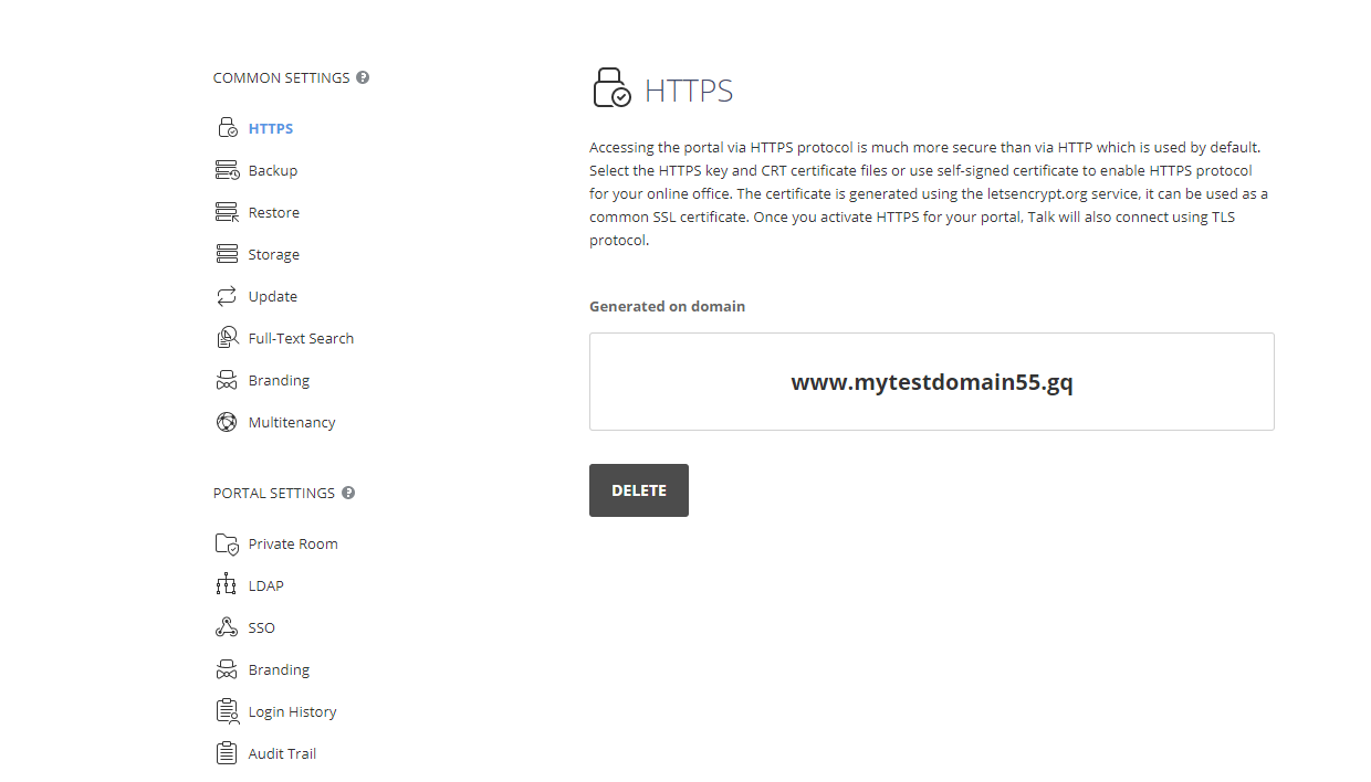

- After that your Control Panel and portal will be restarted and become unavailable during this process. It can take up to 5 minutes. Once the certificate installation process is over, your portal will be available over HTTPS. The domain name that your certificate was issued for is now displayed in the Generated on domain section of the HTTPS page in the Control Panel.
