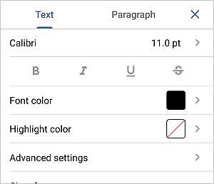

To apply the formatting to the text, select it and open the text and paragraph settings panel by:
- tapping the
icon at the top or bottom toolbar, or - tapping the
option in the pop-up menu,
On the Text tab, use one of the available settings. Use the
icon on the left to return to the previous settings section.
Bold - tap this icon to make the font bold giving it more weight.
Italic - tap this icon to make the font italicized giving it some right side tilt.
Underline - tap this icon to make the text underlined with the line going under the letters.
Strikethrough - tap this icon to make the text struck out with the line going through the letters.

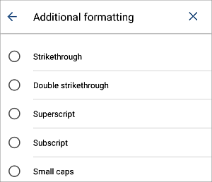

Swipe up and tap the Addvanced settings option. Use one of the following options:
- Strikethrough is used to make the text struck out with the line going through the letters.
- Double strikethrough is used to make the text struck out with the double line going through the letters.
- Superscript is used to make the text smaller and place it to the upper part of the text line, e.g. as in fractions.
- Subscript is used to make the text smaller and place it to the lower part of the text line, e.g. as in chemical formulas.
- Small caps is used to make all letters lower case.
- All caps is used to make all letters upper case.
- Character spacing is used to set the space between the characters. Tap
or
arrows to decrease or increase the current value.
