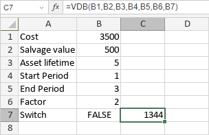

Examples
The figure below displays the result returned by the VDB function.
