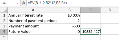

The figure below displays the result returned by the PV function.
