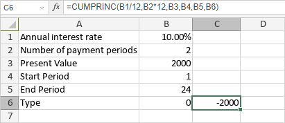

The figure below displays the result returned by the CUMPRINC function.
CUMPRINC Function
