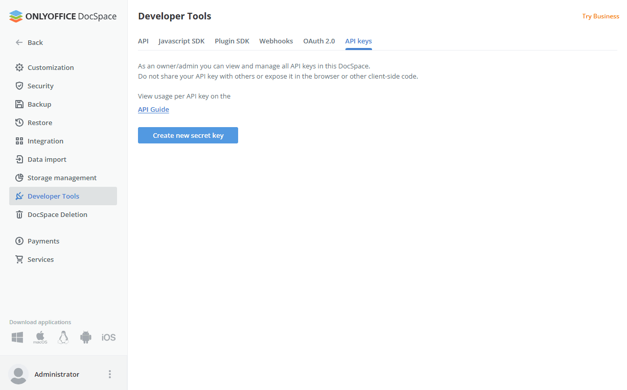

- Generate your own DocSpace api key. The Custom Headers authentification method is less secure compared to OAuth therefore it's not advisable to use the Owner's or the Room Manager's API keys. To generate an API key, go to your DocSpace. Click the Developer Tools tab in the left panel. Choose the API keys tab on top and click the Create new secret key button. Copy the generated key.

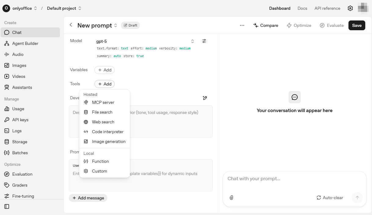

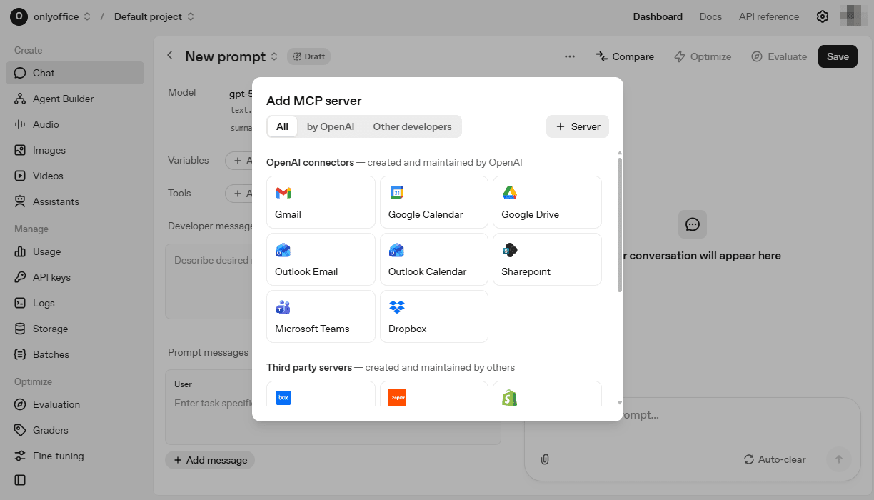

- Access your OpenAI account and open a new prompt in Chat.
- Find Tools option and click the Add button.
- In the window that opens, click Server in the upper right corner.

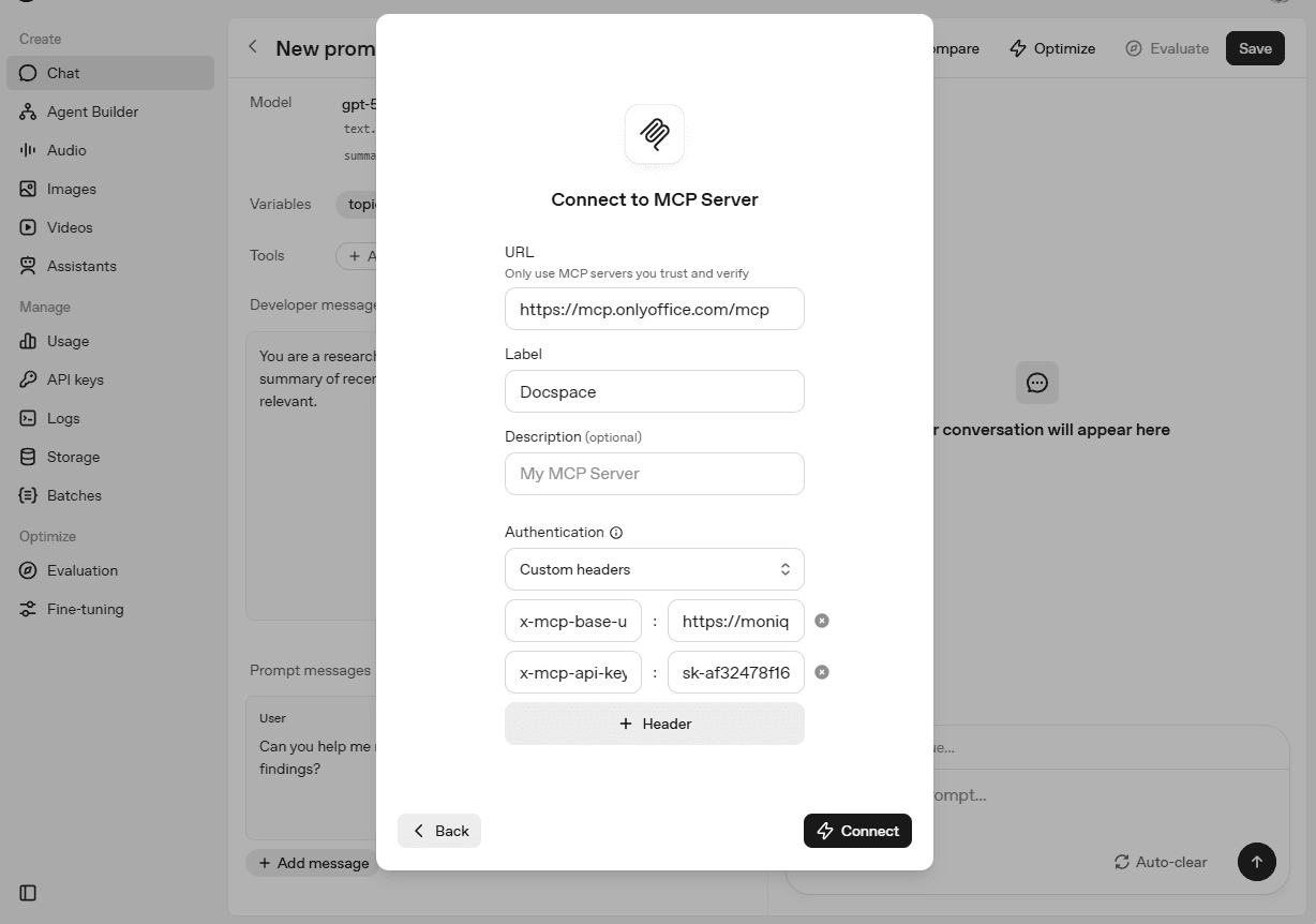

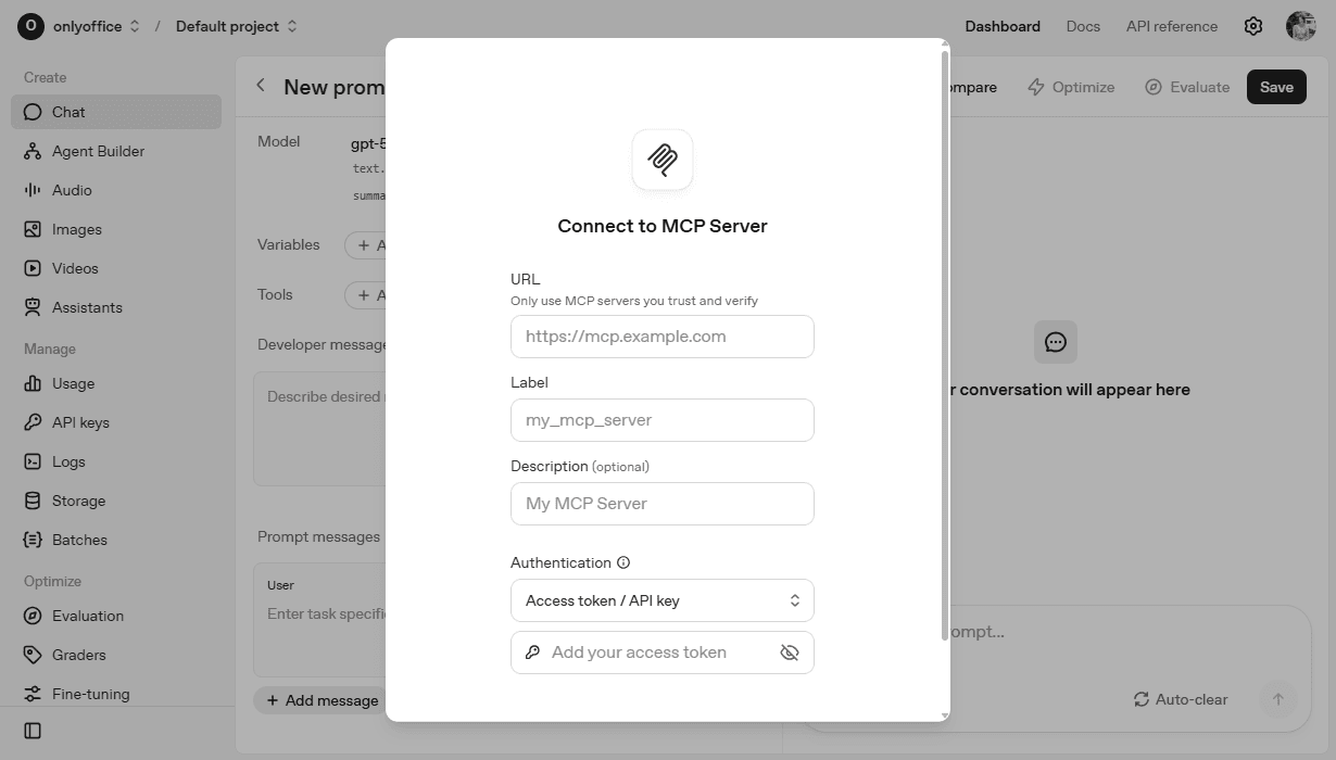

- Fill in the required MCP server parameters:
- URL:
https://mcp.onlyoffice.com/mcp - Label – fill in the name to distinguish the MCP server.
- Description – give a short desription for the MCP Server to improve the server identificaton. It’s an optional parameter.
- Authentification – define the authentification method and settings. Choose Custom headers from the drop-down list, and use your
DocSpaceAPI keyandbase URLof your DocSpace portal to connect to. Fill in the fields that open as follows:X-Mcp-Base-Url: https://your-instance.onlyoffice.com/
X-Mcp-Api-Key: sk-a499e...X-Mcp-Base-Url - web adress of your Docspace for the MCP Server to connect to the right portal.
X-Mcp-Api-Key - the DocSpace API key that has been generated as described is Step 1 abovw to authorize the MCP Sever's access to DocSpace.
- URL:
- Click Connect and wait for the connection to establish.

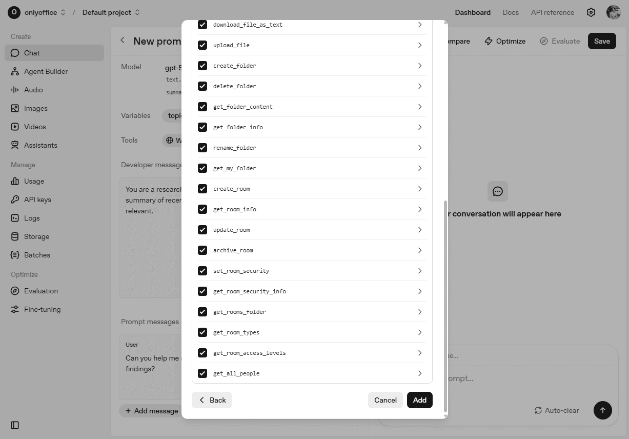

- As soon as the MCP Server connects, you will see the list of the MCP server tools. Choose the necessary tools or choose all, and click the Add button at the bottom of the list.

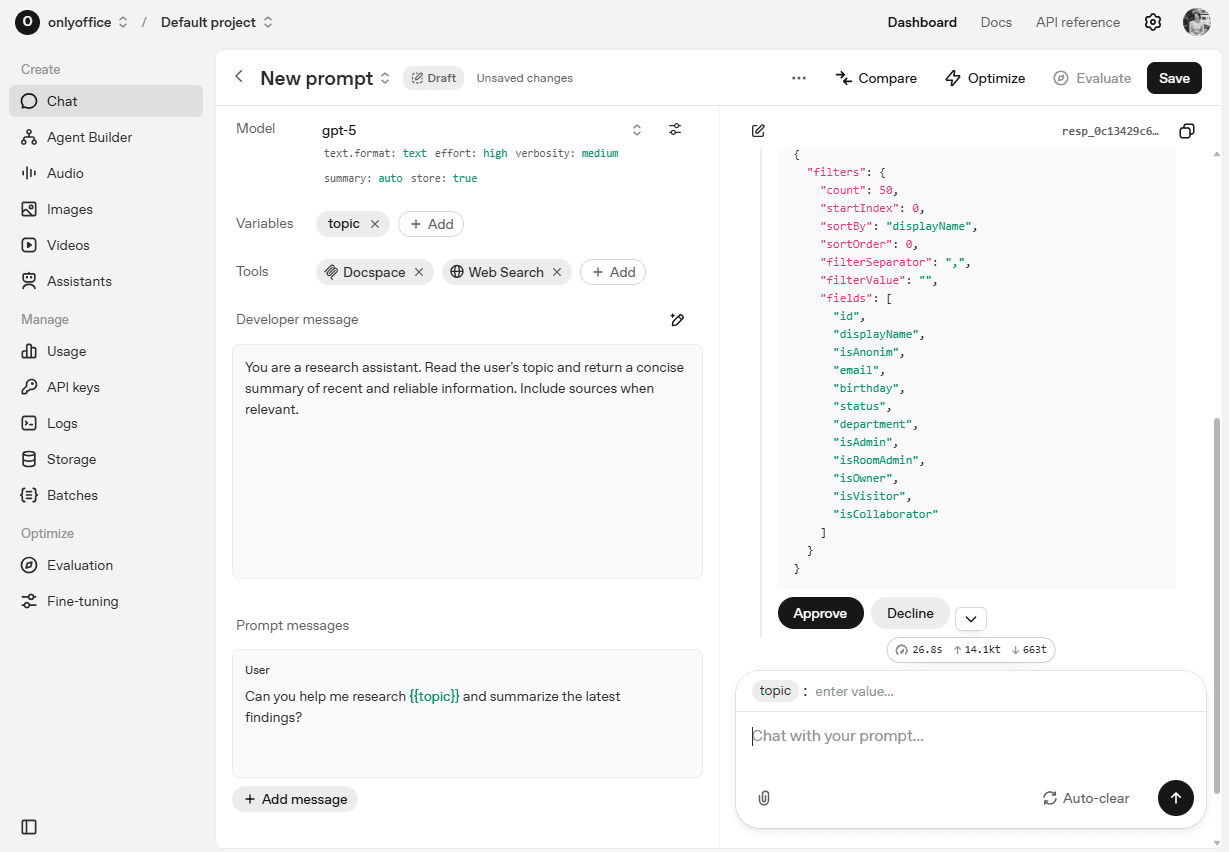

- Use the OpenAI chat with the DocSpace MCP Server tools connected. Give your prompt, click Approve to confirm the list of tools used to respond to your prompt.
