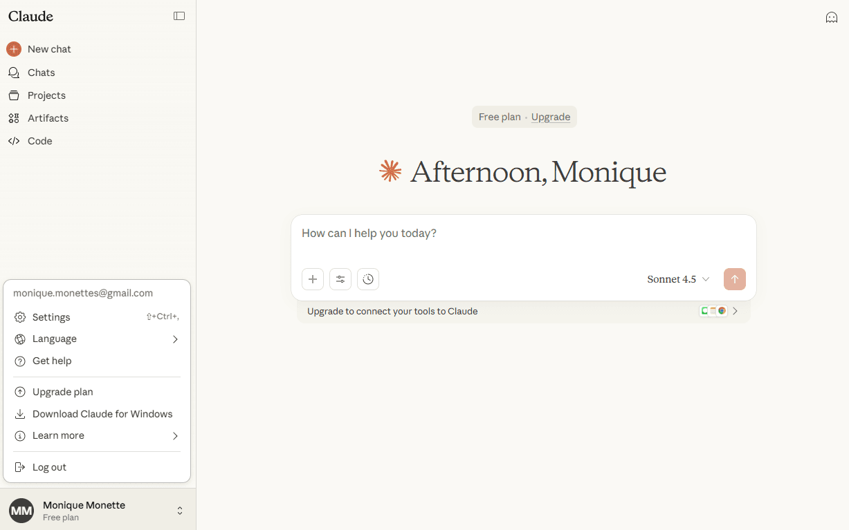

  1. Access your Claude account and go to Settings.
    Claude settings Claude settings

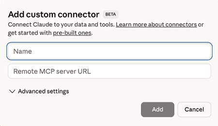

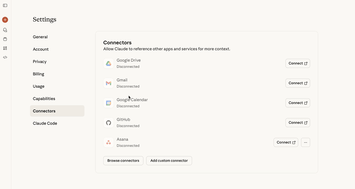

  2. On the Settings page, go to Connectors and click the Add custom connector button.
    Custom connector Custom connector

  1. Enter the connector name.
  2. Remote MCP server URL - enter the ONLYOFFICE MCP Server URL:
    https://mcp.onlyoffice.com/mcp
  3. Click the Add button to complete the authentication.

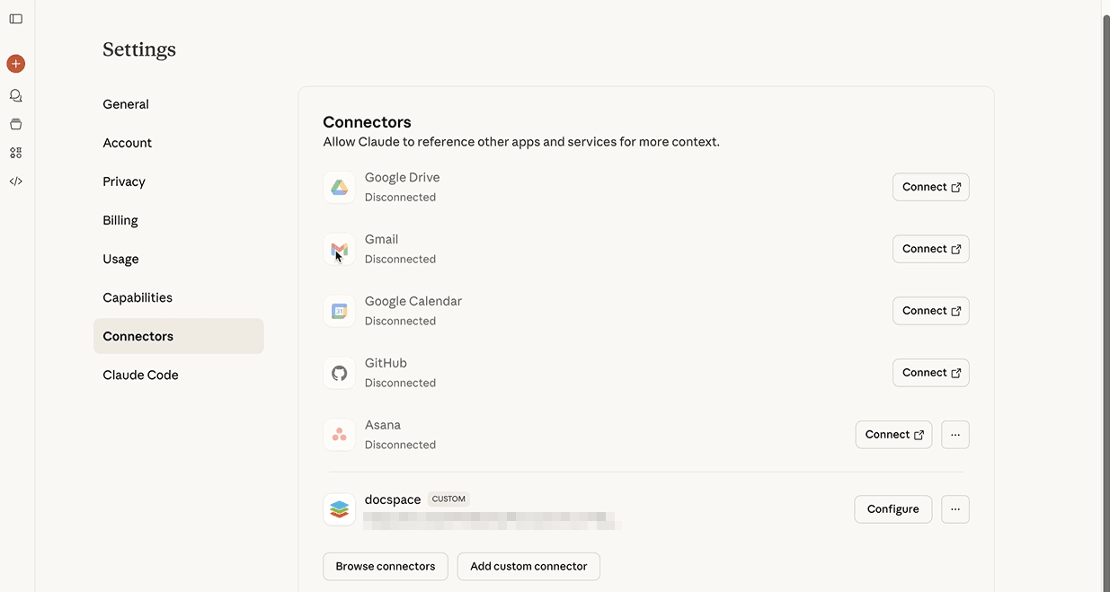

    MCP server parameters MCP server parameters
Using the ONLYOFFICE MCP Server
  • After a successful authentication, the connector will be added to the list of the available connectors.

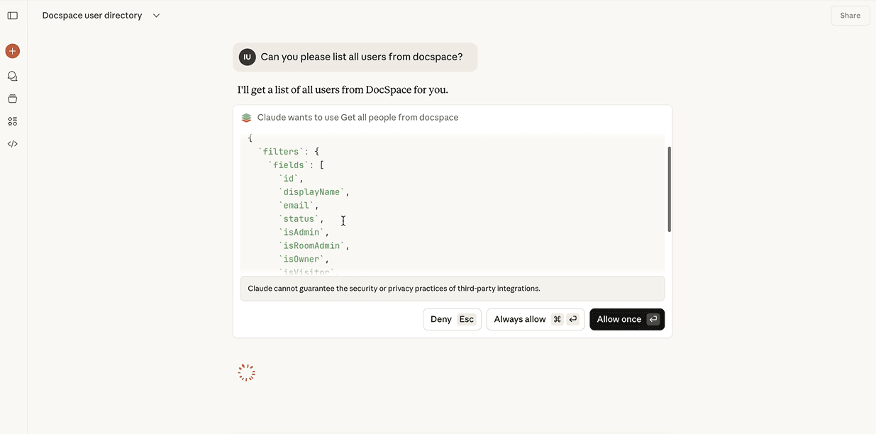

  • Open the chat and give your prompt, click Always allow or Allow once to confirm the list of tools used to respond to your prompt.
    Approve tools Approve tools
