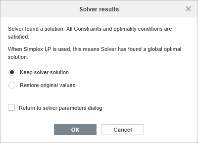

  4. The Solver results window will display the outcome:
    • If a solution is found, you will see a message indicating that Solver found a solution that satisfies all constraints.
    • Choose whether you want to keep solver solution (you can see it in the spreadsheet in the background) or to restore original values.
    • You can return to solver parameters dialog to adjust them more by clicking the corresponding checkbox.
    • Click OK to keep the solution values in your spreadsheet.
    • Click Cancel to restore the original values before the optimization.
