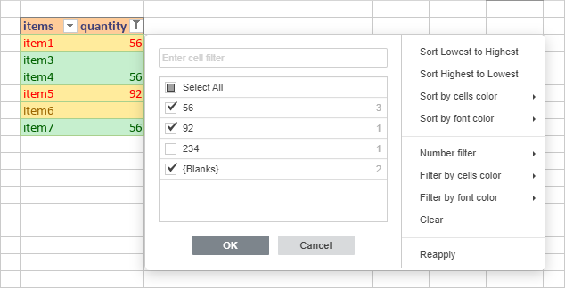

To apply a filter,
Click the drop-down arrow
. The Filter option list will open:
Note: you can adjust the size of the filter window by dragging its right border to the right or to the left to display the data as convenient as possible.
Adjust the filter parameters. You can proceed in one of the following ways: select the data to display, filter the data by certain criteria, or filter data by color.
Select the data to display
Uncheck the boxes near the data you need to hide. For your convenience, all the data within the Filter option list are sorted in ascending order.
The number of unique values in the filtered range is displayed to the right of each value within the filter window.
Note: the {Blanks} check box corresponds to the empty cells. It is available if the selected cell range contains at least one empty cell.
To facilitate the process, make use of the search field on the top. Enter your query, entirely or partially, in the field - the values that include these characters will be displayed in the list below. The following two options will also be available:
- Select All Search Results - is checked by default. It allows selecting all the values that correspond to your query in the list.
- Add current selection to filter - if you check this box, the selected values will not be hidden when you apply the filter.
After you select all the necessary data, click the OK button in the Filter option list to apply the filter.

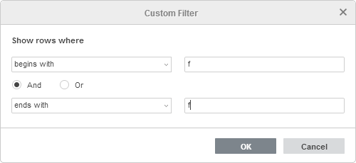

Filter data by certain criteria
Depending on the data in the selected column, you can choose either the Number filter or the Text filter option on the right side of the Filter options list, and then select one of the options from the submenu:
- For the Number filter the following options are available: Equals..., Does not equal..., Greater than..., Greater than or equal to..., Less than..., Less than or equal to..., Between, Top 10, Above Average, Below Average, Custom Filter....
- For the Text filter the following options are available: Equals..., Does not equal..., Begins with..., Does not begin with..., Ends with..., Does not end with..., Contains..., Does not contain..., Custom Filter....
After you select one of the above options (apart from Top 10 and Above/Below Average), the Custom Filter window will open. The corresponding criterion will be selected in the upper drop-down list. Enter the necessary value in the field on the right.
To add one more criterion, use the And radio button if you need the data to satisfy both criteria, or click the Or radio button if either or both criteria can be satisfied. Then select the second criterion from the lower drop-down list and enter the necessary value on the right.
Click OK to apply the filter.
If you choose the Custom Filter... option from the Number/Text filter option list, the first criterion is not selected automatically, you can set it yourself.

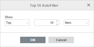

If you choose the Top 10 option from the Number filter option list, a new window will open:
The first drop-down list allows choosing if you wish to display the highest (Top) or the lowest (Bottom) values. The second field allows specifying how many entries from the list or which percent of the overall entries number you want to display (you can enter a number from 1 to 500). The third drop-down list allows setting the units of measure: Item or Percent. Once the necessary parameters are set, click OK to apply the filter.

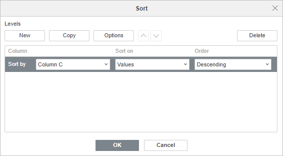

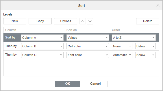

Sort data by several columns/rows
To sort data by several columns/rows, you can create several sorting levels using the Custom Sort function.
- select a cell range you wish to sort (you can select a single cell to sort the entire range),
- click the Custom Sort
icon situated on the Data tab of the top toolbar, -
the Sort window will appear. Sorting by columns is selected by default.
use the Levels sections to add new levels and to manage the added levels.
- New button to add a new level, select the second column / row you want to sort and specify other sorting parameters in the Then by field as described above. If necessary, add more levels in the same way,
- Copy button to copy the selected level and to duplicate all the existing settings,
Options button to change the sorting orientation (i.e., sorting data by rows instead of columns). Click the button to open the Sort Options window:
- check the My data has headers box, if necessary
- choose the necessary Orientation: Sort top to bottom to sort data by columns or Sort left to right to sort data by rows,
- click OK to apply the changes and close the window.
- Delete button to delete the selected level,
- Arrow buttons Move the level up / Move the level down to change the order of levels.
set the first sorting level in the Sort by field:
- in the Column / Row section, select the first column / row you want to sort,
- in the Sort on list, choose one of the following options: Values, Cell color, or Font color,
in the Order list, specify the necessary sorting order. The available options differ depending on the option chosen in the Sort on list:
- if the Values option is selected, choose the Ascending / Descending option if the cell range contains numbers or A to Z / Z to A option if the cell range contains text values,
- if the Cell color option is selected, choose the necessary cell color and select the Top / Below option for columns or Left / Right option for rows,
- if the Font color option is selected, choose the necessary font color and select the Top / Below option for columns or Left / Right option for rows.
The data will be sorted according to the specified sorting levels.
