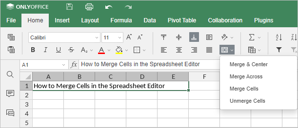

Type 1. Merge and Align Center
Click on the cell at the beginning of the needed range, hold the left mouse button, and drag until you select the cell range you need.
The selected cells must be adjacent. Only the data in the upper-left cell of the selected range will remain in the merged cell. Data in other cells of the selected range will be deleted.
Go to the Home tab and click on the Merge and center icon

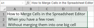

Type 2. Merge Across
Go to the Home tab and click on the arrow next to the Merge and center
icon to open a drop-down menu.
Choose the Merge Across option to align the text left and preserve the rows without merging them.

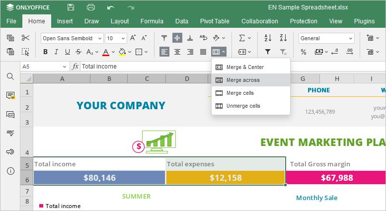

Type 3. Merge Cells
- Choose the Merge Cells option to preserve the preset alignment.

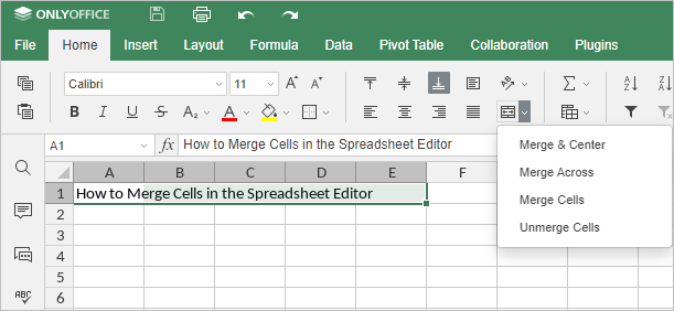

Unmerge Cells
Click on the merged area.
- Choose the Unmerge Cells option to bring the cells back to their original state.
