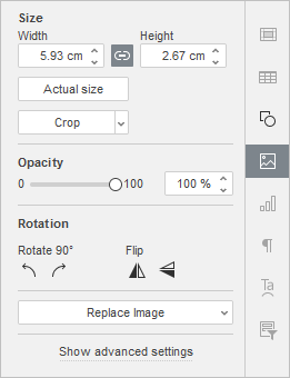

To specify the exact dimensions of the image:
  1. Select the required image with the mouse.
  2. Click the image settings icon Image settings icon on the right sidebar.
    Image Settings Right-Side Panel window
  3. In the Size section, set the necessary Width and Height values. If the Constant proportions constant proportions icon button is clicked (in this case it looks like this constant proportions activated icon), the width and height will be changed together, preserving the original image aspect ratio. To restore the actual size of the added image, click the Actual Size button.

Changing opacity
Opacity - use this section to set the Opacity level by dragging the slider or entering the percent value manually. The default value is 100%. It corresponds to the full opacity. The 0% value corresponds to the full transparency.
Rotating an image
To rotate the image:
  3. In the Rotation section, click one of the buttons:
    • rotate counterclockwise icon to rotate the image by 90 degrees counterclockwise.
    • rotate clockwise icon to rotate the image by 90 degrees clockwise.
    • flip left to right icon to flip the image horizontally (left to right).
    • flip upside down icon to flip the image vertically (upside down).

Replacing an image
To replace the inserted image:
  3. Click the Replace Image button.
  4. Choose the necessary option: From File, From Storage, or From URL and select the desired image.
    Alternatively, you can right-click the image and use the Replace image option from the contextual menu.
The selected image will be replaced.

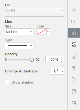

When the image is selected, the shape settings icon Shape settings icon is also available on the right. You can click this icon to open the Shape settings tab on the right sidebar and adjust the shape line type, size, color, and opacity, as well as change the shape type by selecting another shape from the Edit shape menu. The shape of the image will change correspondingly.
On the Shape Settings tab, you can also use the Shadow option to add a shadow to the image.
Shape Settings tab

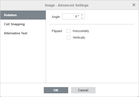

Image - Advanced Settings: Rotation
The Rotation tab contains the following parameters:
  • Angle — use this option to rotate the image by an exactly specified angle. Enter the necessary value measured in degrees into the field or adjust it using the arrows on the right.
  • Flipped — check the Horizontally box to flip the image horizontally (left to right) or check the Vertically box to flip the image vertically (upside down).

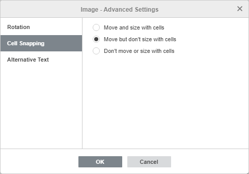

Image - Advanced Settings: Cell Snapping
The Cell Snapping tab contains the following parameters:
  • Move and size with cells — this option allows you to snap the image to the cell behind it. If the cell moves (e.g., if you insert or delete some rows/columns), the image will be moved together with the cell. If you increase or decrease the width or height of the cell, the image will change its size as well.
  • Move but don't size with cells — this option allows you to snap the image to the cell behind it, preventing the image from being resized. If the cell moves, the image will be moved together with the cell, but if you change the cell size, the image dimensions remain unchanged.
  • Don't move or size with cells — this option allows you to prevent the image from being moved or resized if the cell position or size was changed.

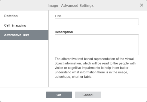

Image - Advanced Settings: Alternative Text
The Alternative Text tab allows you to specify the Title and the Description which will be read to people with vision or cognitive impairments to help them better understand what information the image contains.

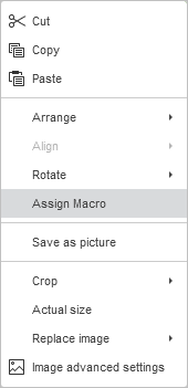

Assign a macro to an image
You can provide quick and easy access to a macro within a spreadsheet by assigning a macro to any image. Once you assign a macro, the image appears as a button control, and you can run the macro whenever you click it.
To assign a macro:
  1. Right-click the image to assign a macro to it and choose the Assign Macro option from the drop-down menu.
    Assign Macro on Menu
  2. The Assign Macro dialogue will open.
  3. Choose a macro from the list, or type in the macro name, and click OK to confirm.
